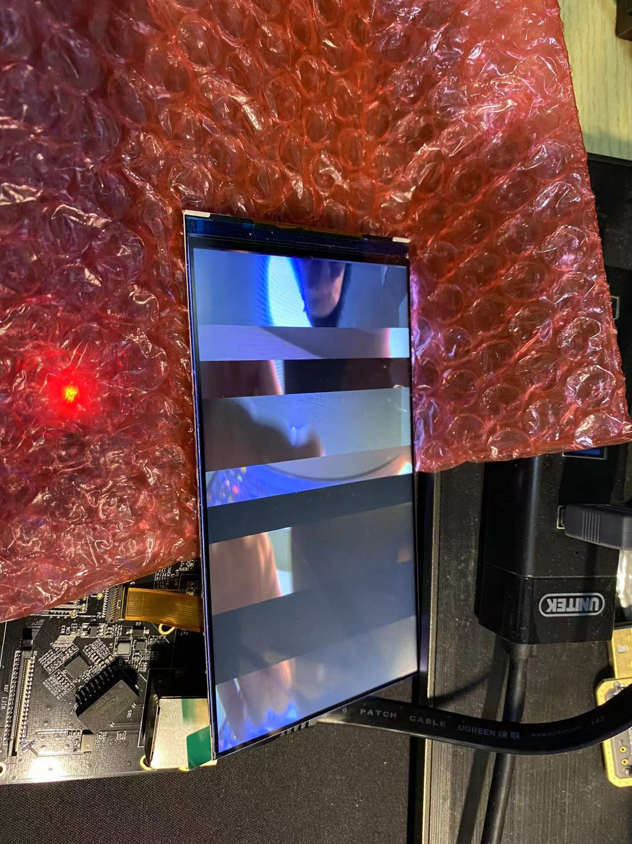

Furthermore,I want to use two frame buffer mode to show LVGL 8,
I had got some code from Internet which used on LVGL 7, but when I use it on LVGL 8, it not work well,
just like this.
Hi!
You can use a lv_canvas and use camera buffer to write to it, also you can set a area on your lvgl application where you will not render anything and use the x,y, width and height of this area to write your camera feed.
