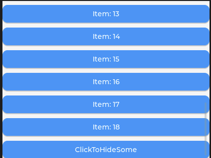

To start off, scroll to the bottom:

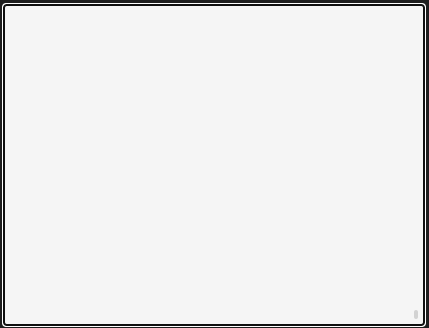

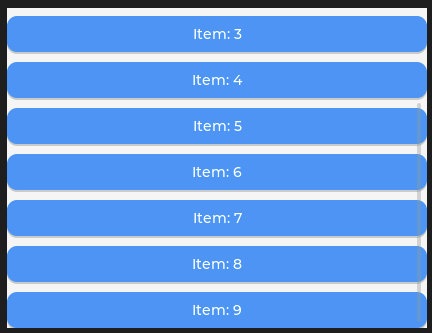

After clicking ‘ClickToHideSome’(which hides items 10 and further, but scroll hasn’t been updated, so user is lost):
So at this point, I’m looking for a snippet of code that will cause LVGL to scroll up, or down, until the available widgets are within the screen. For this example, it should scroll to here(if we were scrolled where item -100 should be, function should scroll until Item:0 is at the top instead) :
