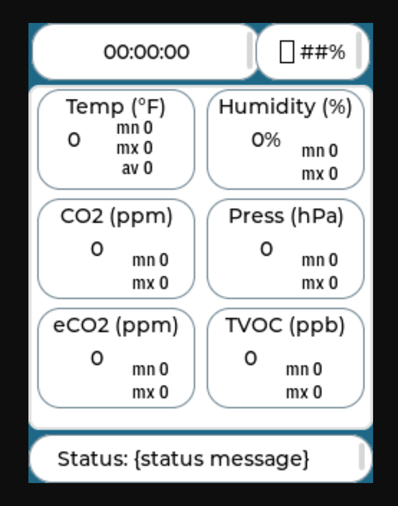

I removed lv_xml_register and when deployed on the system the text associated with that font is just omitted completely. Is there a way to get around this or is it a matter of dropping XML entirely anytime I use a custom font?
Deployed build:
Preview build (WIP):
I have barerly used XML, only started looking into it this week…

Thanks that worked. Simpler than what I was doing before with the lv_xml stuff.
