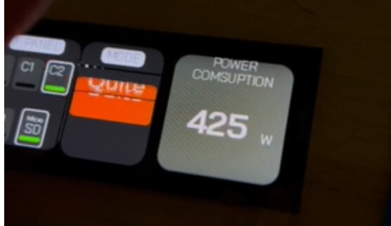

I have a screen resolution of 172x640. I tested and found that the starting coordinates x1 of the pixels I write cannot be odd numbers, otherwise the screen will tear.
Although I can solve this problem by turning on full screen refresh, I cannot use full screen refresh after turning on horizontal screen in lvgl.
So the problem I am facing now is that after turning the screen horizontally, I can’t refresh the full screen. How can I modify it so that the starting coordinates x1 of the local refresh area remain an even number?

This is a defect in the screen driver itself, not a software problem.
video:https://drive.google.com/file/d/1cyYTNPh2ErzOeT36a6PTIVfpRWjXqbWg/view?usp=sharing
