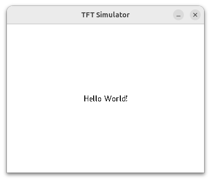

Result without loading font at runtime.

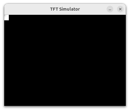

Window looks like this before seg-faulting with the code above.
