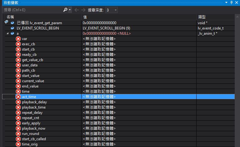

I want to disable the scroll animations of TableView. I have referenced to the example " Tabs on the left, styling and no scrolling". As the example, a call back function is used to disable the scroll animations of TableView. The problem is that the event-parameter is null, and the scroll animations can not be disable via set the variable “time” of the event-parameter as zero.

As the figure show, the variables of a(lv_anim_t* a = lv_event_get_param(e);) can not be read.
