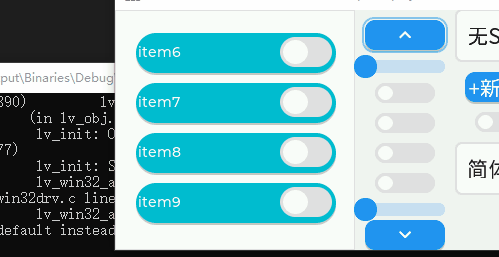

I guess this is not the effect he wants. For example, I have a list with 1-10 options. I want it to go from 1 to 10, and then from 10 to 1, just like a roller.

list
Is it an effect? I’m sorry for I can’t put the code here, because it does seem a bit excessive, and some of it belongs to a commercial project, but we can discuss the core parts here.
this is exactly what im talking about. but with keyboard and keypad
