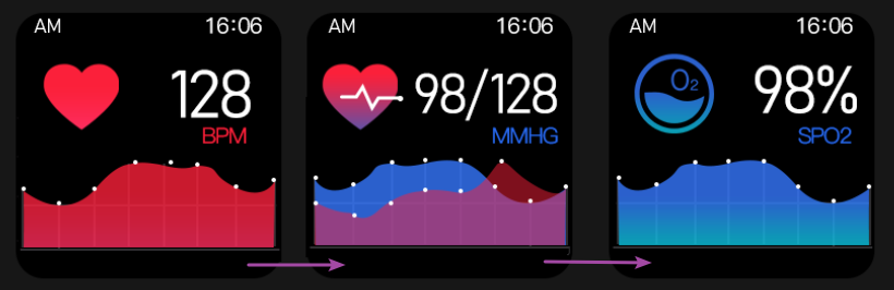

Hello everyone, I want to create multiple pages to show various functions. Is there any good way to implement it? Or what controls are better?

Hello, tarvik, thank you very much for your reply, um, this is my first post. My app is a smart bracelet watch. I want to slide to the next page, and see what I sent, you probably understand it.I look forward to your reply again.
This sounds like the perfect application for a tabview. Did you see the example tabview in the documentation I referenced above?
I don’t know if you want to have visible tabs for these individual screens or not, but I suspect you do not. Fortunately you can easily hide the tabs and just use the swipe to go between pages. This is some pseudo-code off the top of my head to get you started.

Hello, tarvik, thank you again for your good advice. I want to use the TabView control to achieve multiple pages for sliding effects. When I swipe to the next page, is it necessary to manually delete the current page, then create a new page and add control content?

Hello, Anda, how do you achieve the smooth curve at the top of the chart and the darkness at the bottom?
