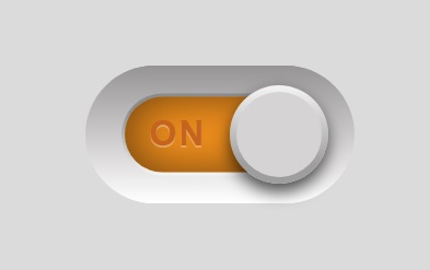

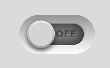

How to convert a beautiful html / CSS switch code in lvgl code
Create a beautiful switch in lvgl.
Gemini ai conversion code.
beautiful_button.zip (1.3 KB)
Screenshot
off
on
  • MCU/MPU/Board:
    ESP32-S3
  • LVGL version: See lv_version.h
    9.3.0
Would I be able to convert using lvgl pro ?
I’ve never used lvgl pro.
@Baldhead, I tried created something similar to this image using Figma, but it’s necessary install two plugins : html to design and LVGL plugin to Figma
After that you can copy the styles to LVGL Editor do some adjustments. Here is final result:
Code generated by Editor:
switch.zip (4.2 KB)
