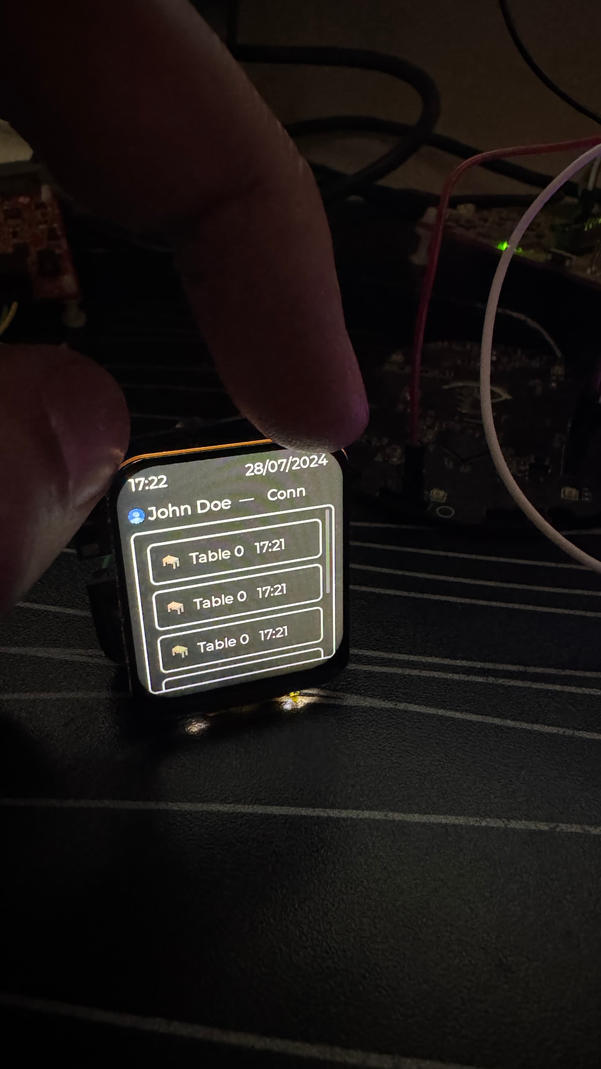

Now the main issue is that I am not able to know when the list is not scrollable anymore and therefore my current_scroll_y variable keeps on incrementing when I press the button. This issue exists only on scrolling downwards and not upwards.
Here is what actual lists look like
