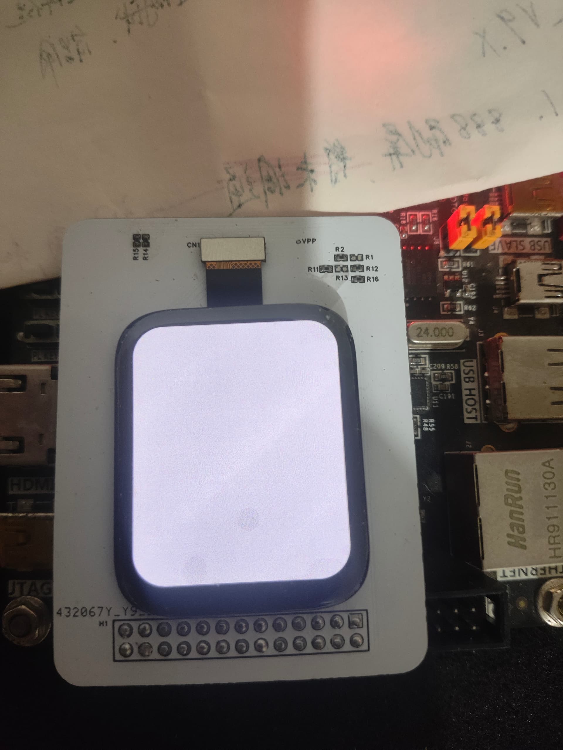

RGB888 format(All white pixels),Disable the RGB/BGR function of the screen.

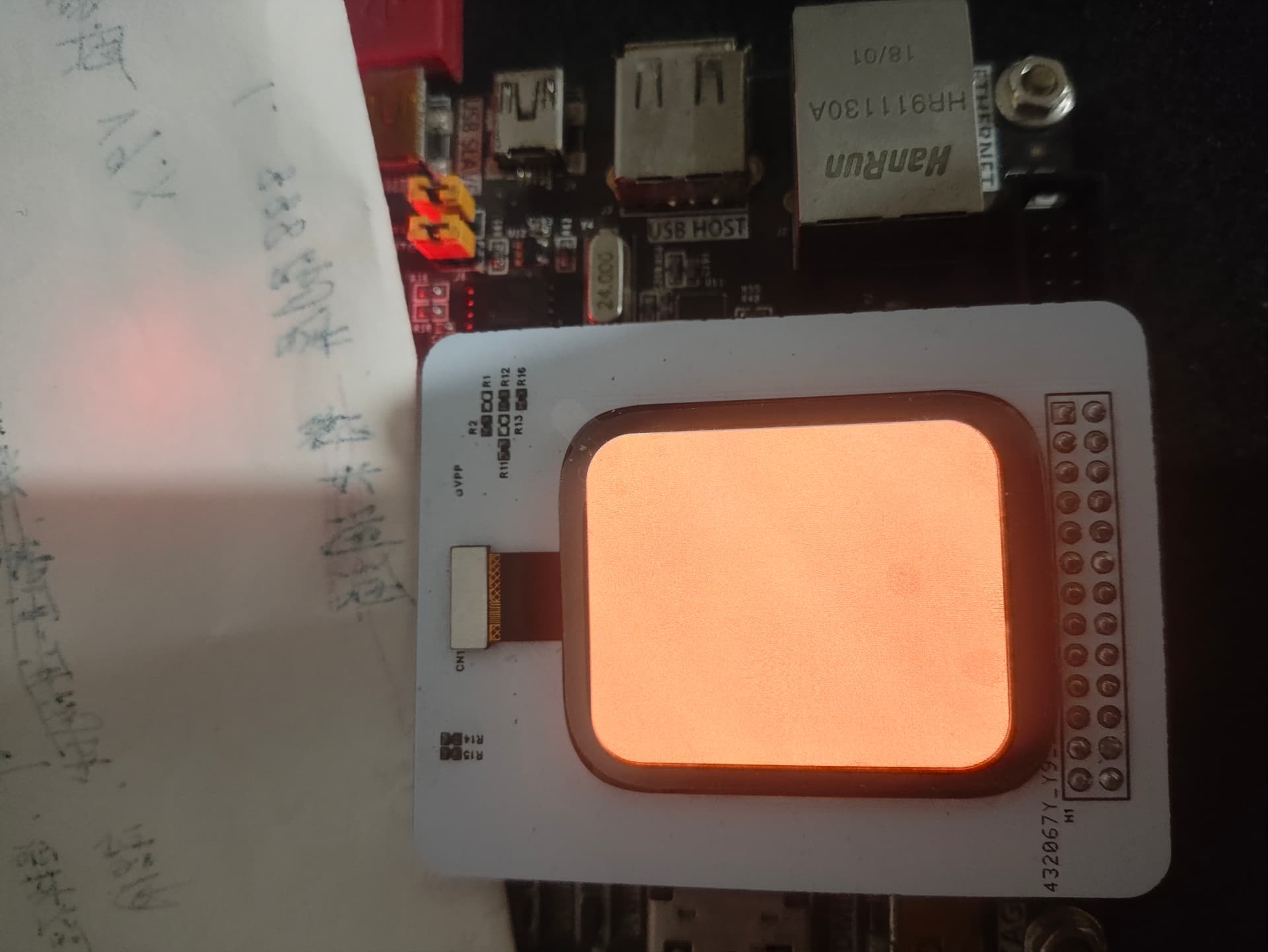

BGR888 format(All white pixels),Use the RGB/BGR function of the screen.
