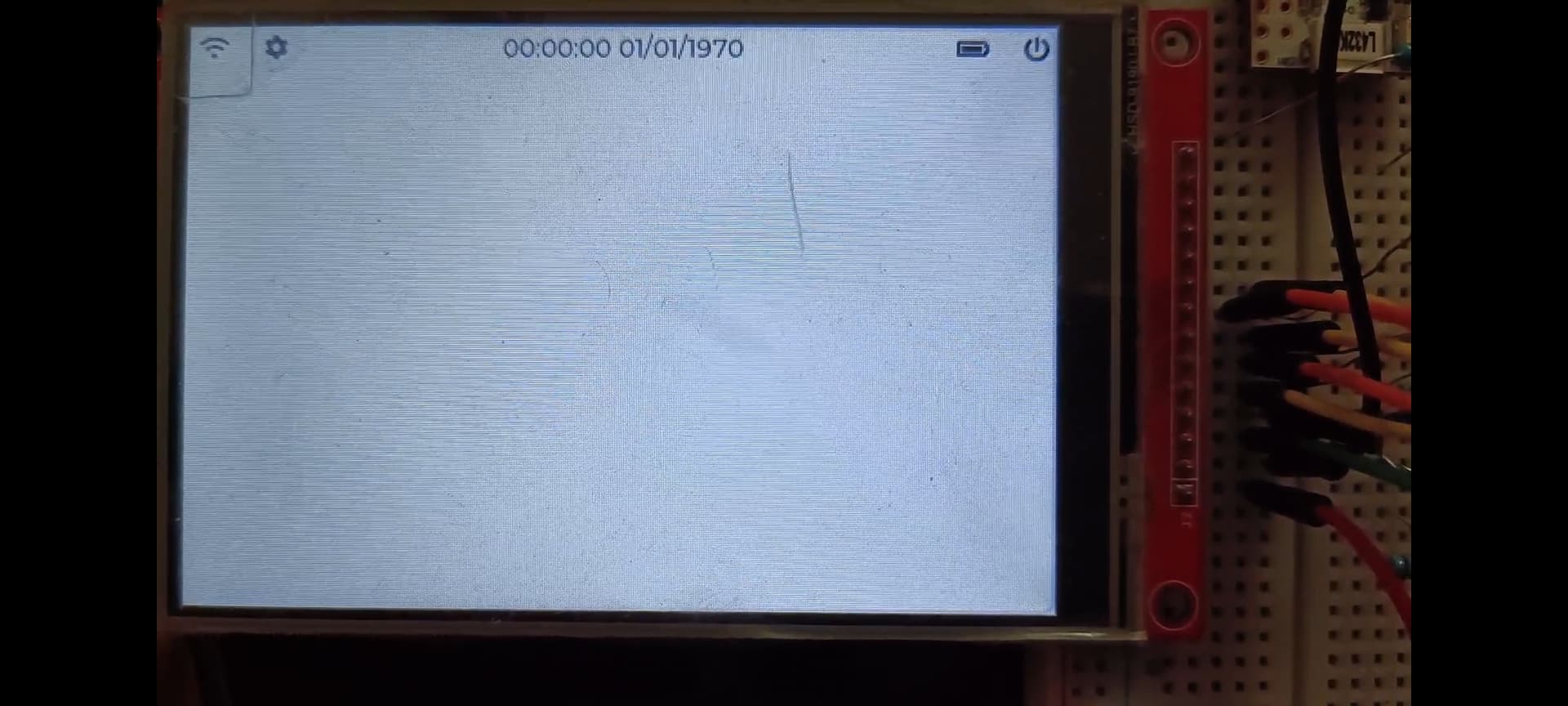

But there is a weird result in my LCD screen. The first text is fine:

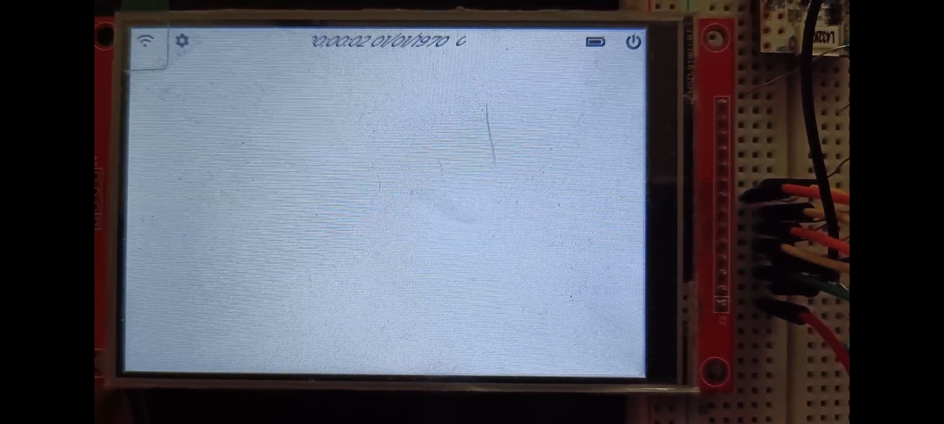

But the second one is totally weird, and we can see at the right a 0, probably of the previous text. I don’t know why.

To resolv this issue, I tried to put before the lv_label_set_text(time_label, buffer); this line:
lv_label_set_text(time_label, "");, even this line lv_label_set_text(time_label, NULL);.
I tried to remove all of this and I worked with int to see if it was a datetime problem, it is not. Even with int variable and the lv_label_set_text_fmt() function it is the same problem.

Your timer implementation is correct. Probably it has something to do with the display driver requirements regarding partial flushing.
What display do you have? Can you also share your flush_cb implementation
