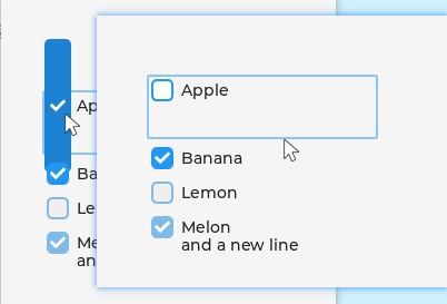

I use demo “lv_example_checkbox_1” to test change indicator size of the check box, what I use is the function " lv_obj_set_style_transform_height" , and different selctor value also used.
When I use “LV_PART_INDICATOR | LV_STATE_DEFAULT” or “LV_PART_INDICATOR”, the indicator is the height I set when release, but become default height when pressed.
When I use “LV_PART_INDICATOR | LV_STATE_PRESSED | LV_STATE_DEFAULT” or “LV_PART_INDICATOR | LV_STATE_PRESSED”, the indicator is the height I set when pressed, but become default height when release.
My question is, how to keep the height I set both in press and release state.

/** my test code here*/
lv_obj_set_size(cb, 200, 50);
lv_obj_set_style_transform_height(cb, 50, LV_PART_INDICATOR | LV_STATE_PRESSED | LV_STATE_DEFAULT);
/** end of my test code */
