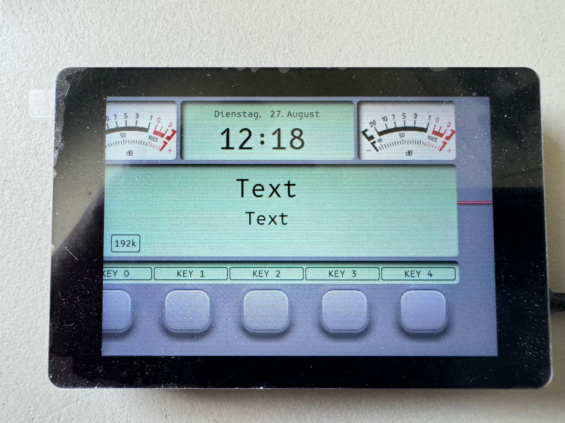

Working on an internet-radio with VU-meters I’m facing a strange problem:
I’m using images as needles and for some reason (esp. the right one) is on creation time ( aligned to the right side) its size is going outside the screen.
And as a result (see foto below) the screen is (automatically) extended and now I can swipe the whole screen to the left (see the needle in red drawn on the right side). But this is’n’t what I want…
ESP32S3, PlatformIO
9.1 MASTER
Clipping , if off-screen
Rotate the images und later bring to the desired position - it doesn’t work
One way to do it is to remove the scrollable flag from the screen
lv_obj_remove_flag(screen, LV_OBJ_FLAG_SCROLLABLE);
