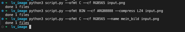

I tried
Als C-Array exportieren
Als BIN-Datei mit Kompression
Ganzen Ordner konvertieren
python3 script.py --ofmt C --cf I8 /pfad/zum/ordner/
Mit benutzerdefiniertem Namen

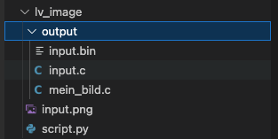

but no output no message from the script just nothing
This seems correct, you did not specify the output folder, so it uses the default “ouptut” which should have been created.
Screenshot 2026-02-10 at 20.24.15
Screenshot 2026-02-10 at 20.24.31
