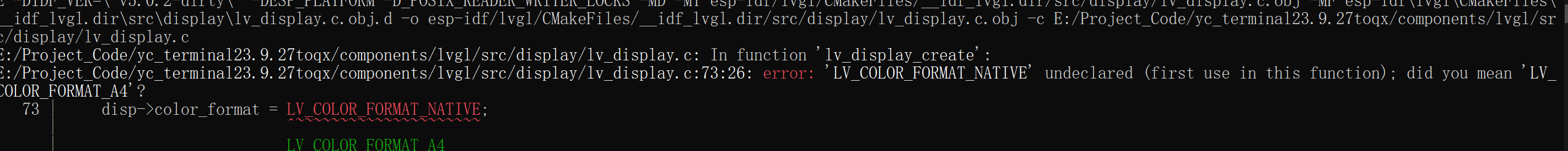

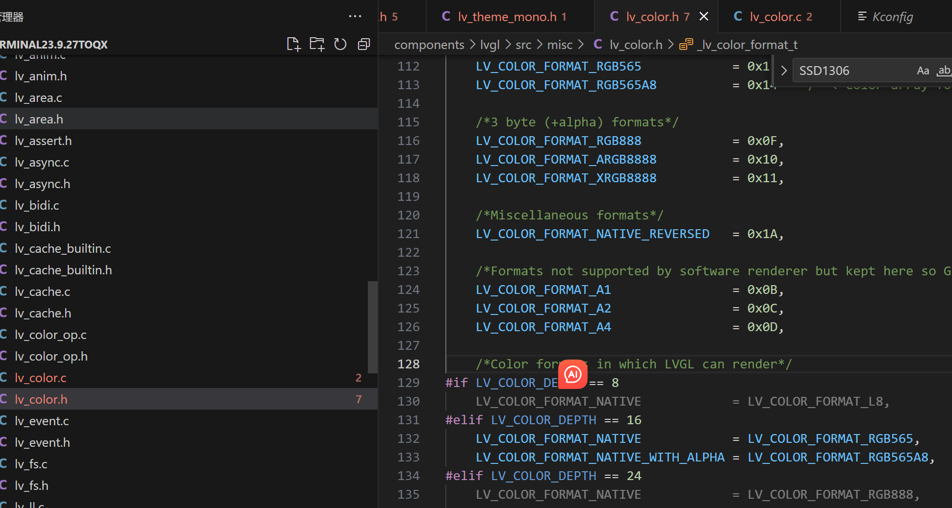

1.used E-paper,set LV_COLOR_DEPTH 1,build error,look logs,it seem nonsupport at least 8,Is it removed in the new version ,How Can i set it,I found some useful information,
config LV_USE_THEME_MONO
bool “Monochrome theme, suitable for some E-paper & dot matrix displays”
default y if LV_COLOR_DEPTH_1 && !LV_CONF_MINIMAL
It needs to be set to the theme and the depth is greater than 8?

Have you checked the latest LVGL versions, I’m able to use LV_COLOR_DEPTH=1 on v9.4
