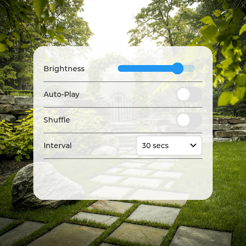

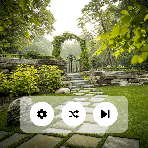

You can keep it simple by loading images directly from the SD card and displaying them using an appropriate image decoder.
LVGL already supports several image formats and decoders. This slideshow example provides a minimal UI with on-screen controls.
You would still need to implement the display driver, configure the filesystem driver and appropriate image decoder, and keep track of the available images.
