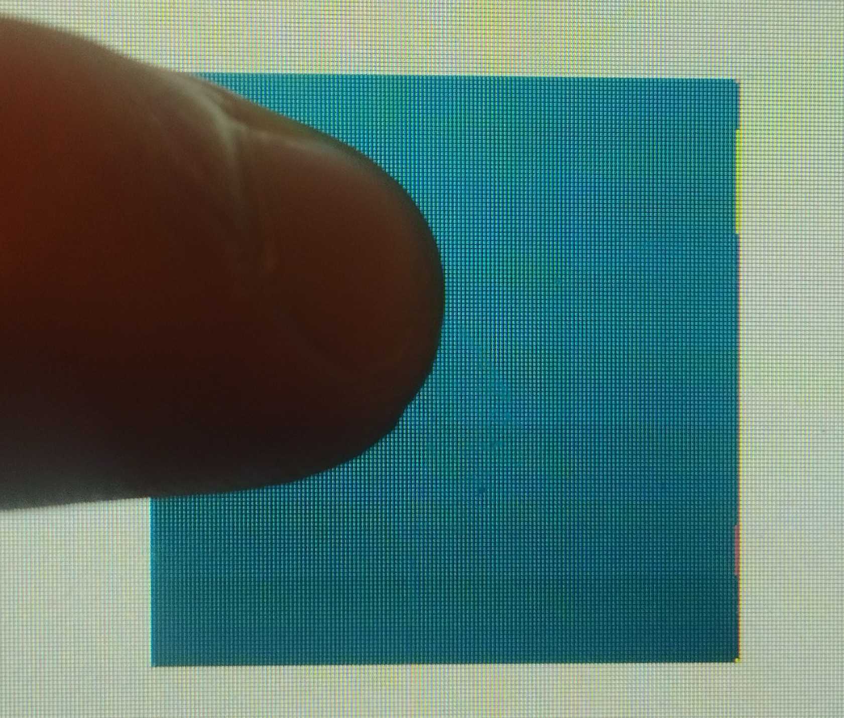

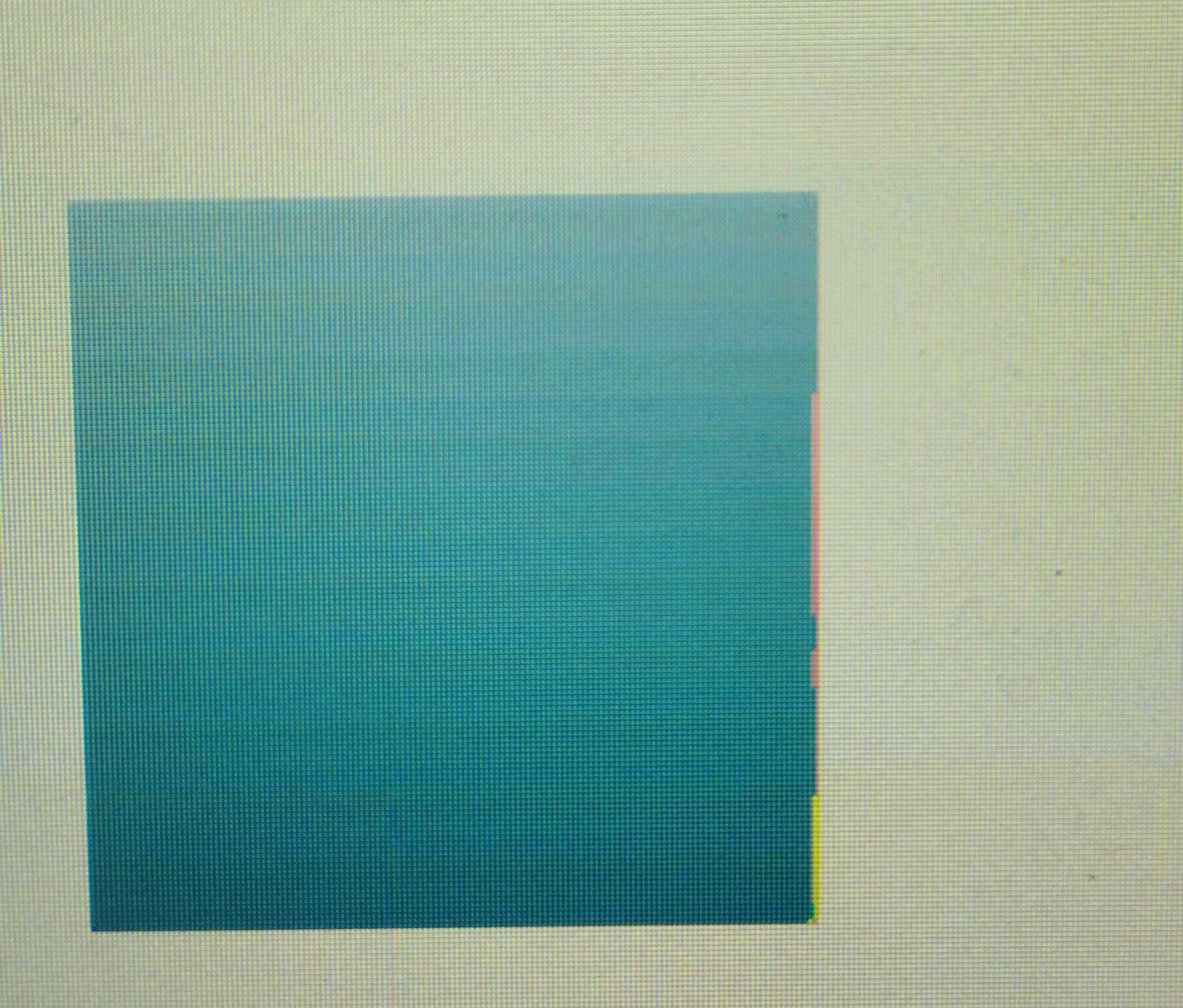

I want to display rectangle with gradient. I am using Microchip SAM9X60 and ETML070023UDRA display. But on the right side there is pink outline, which I want to get rid of it. The gradient that is in the style_pressed looks better.
I tried to save these gradient as an image, additional apply dithering to it, but it does not help. Sometimes changing the gradients’ colors gave better results.
