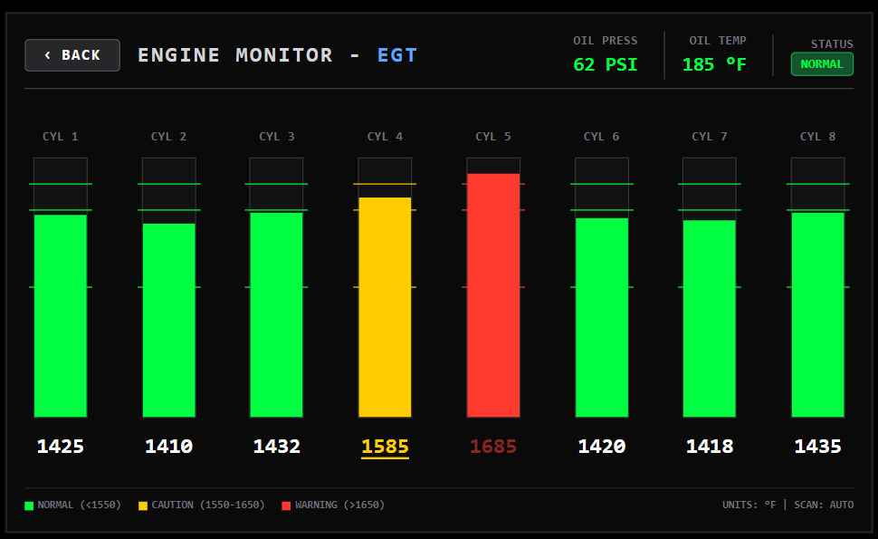

After seeing this post, I give it a try.
And was quite suprised by the result, eventually a better “prompt” and/or “Readme.md” associated to the project is required to explain some stuff.

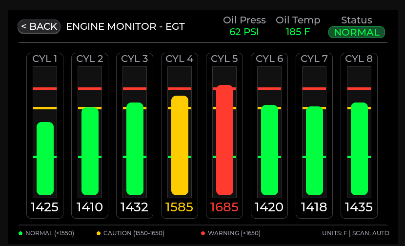

But, this was the original Google Sticht output (this was a very quick test, just two interactions):
Then asked Codex to convert to LVGL XML, no longer have the first “output”, but this is the result after some tunning (specially because of styles and default values like padding and etc…)
This where the prompts to Codex, so it can be a lot better:

Initially it simple “copied” the structure of the html file.
Considering that in this page there some duplicated objects types, it seems to make some sense to create components (reusable block), for example each the "EGT" object, to be a component that includes the title, bar and value
Then it created a component for the “bars”, and updated the xml to reuse them
I see in HTML that they are using "flex" for some stuff, on the header and on the footer... Shouldn't this also be translated to a "Flex" or eventually "grid" equivalent of LVGL, instead of having "fix coordinates"
It regenerated the XML using “flex” for the labels position on the header / Footer and to place/space the “bars” in the middle.
No values are binded, it created “alone whithout my request” “api”/“props” for the component it generated, and the last comment it gave me was asking
If you want, I can do one more pass to convert the hardcoded metric texts to subjects (bind_text) so this screen is fully data-driven.
It created most of the general stuff correct, it didn’t exported the fonts it just used some fonts that I already had in the globals.xml and there were some “visual” issues related to the default theme on the editor having some very large padding values…
