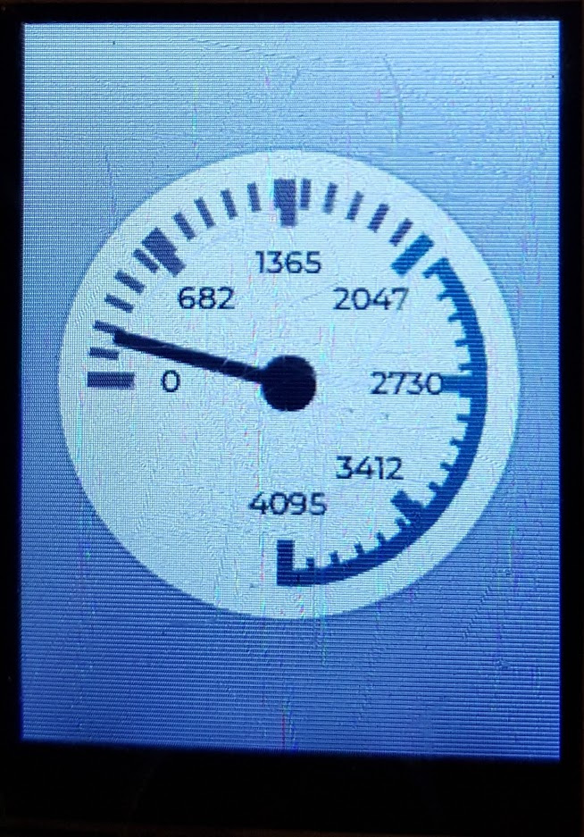

If I declare this font, in lv_conf.h" as LV_THEME_DEFAULT_FONT or if I use it in my script with a set_style_local_text_font()
, I reproduce the reboot, always with the last version of lv_binding only.

self.scr0 = lv.obj()
self.page0= GaugePage(self.scr0)
lv.scr_load(self.scr0)
self.page0.gauge.set_style_local_text_font(lv.gauge.PART.MAIN,lv.STATE.DEFAULT,lv.font_montserrat_medium_14)

Now with this minimal script, it takes 20 seconds to have the reboot.
If I increase the time.sleep()
in the loop, it increases the time delay of reboot.
If I delete the refresh_style
in the set_value()
, the reboot happens later (but the needle display is not fine).
By the end of my tests, I tried to not change lv_conf.h
and I replaced the original lv_font_montserrat_14.c
code by my own font code. Like this, it works, no reboot
