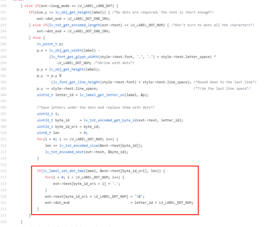

I am using the function “lv_label_set_static_text” with the long_mode: LV_LABEL_LONG_DOT for the text. The problem is that “lv_label_set_static_text” calls “lv_label_refr_text”, and it try to modify the text (replacing the last characters by dots), but the text is const, so it crashes.

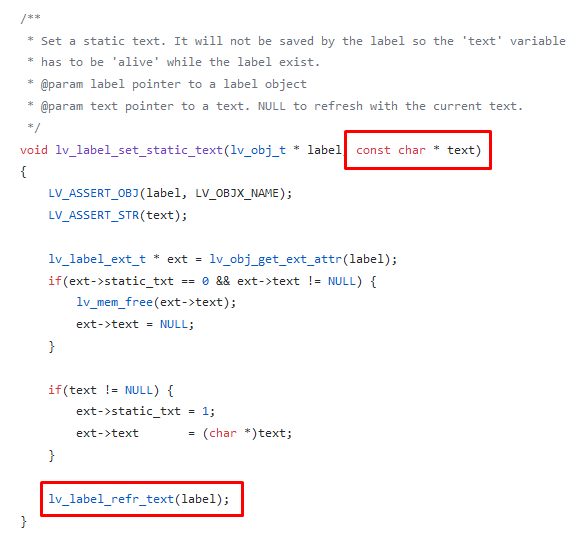

The function “lv_label_set_static_text” has a pointer to a const text as parameter.
And, in function “lv_label_refr_text”, the const text is modified.

I was thinking about this some more. There is nothing wrong with the use of lv_label_set_static_text itself; the problem is with the constant buffer passed to it. As long as the buffer is RW, everything should work fine (the buffer will temporarily be modified by the label and restored).
That’s true. The buffer is not necessarily const.
Do have any suggestions in light of that? Leave it as it is and let the user take care of this possible conflict? (Add note to the docs and comment of course.)
Yes. I committed a change to the docs repository the other day that addresses this. But I don’t think anything in the implementation needs to change. The user should just be aware of this problem, and use lv_label_set_text if they really want to use a constant buffer (although, since it allocates a new buffer anyways, it makes no difference in the end).
