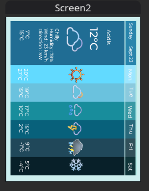

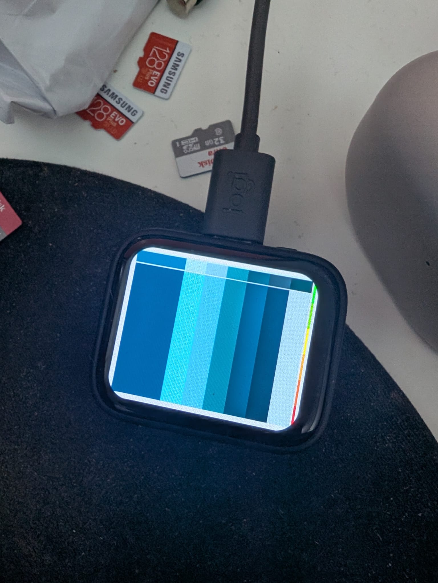

ESP32-S3-Touch-AMOLED-1.8 Not showing lables images and texts
screen2 (1)
If you face this issue before or if u have any solutions for it I appreciate it
What driver does your screen use?
You might have to implement a rounder callback
