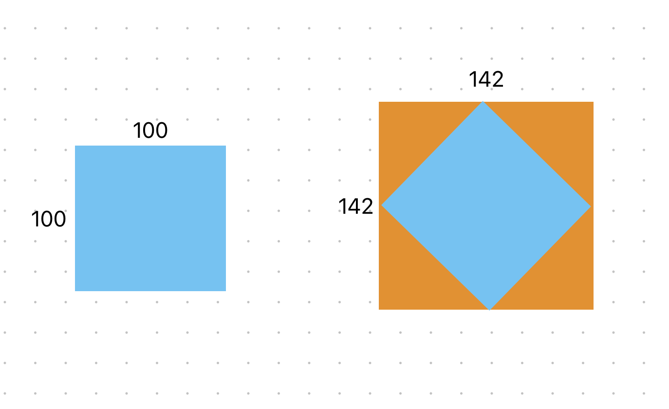

Rotations, especially large ones, can be expensive. LVGL must first render the object to a temporary layer, apply the rotation, and then blend the transformed result into the draw buffer. This adds extra processing and may require additional temporary memory.
Example, a 100x100 object when rotated by 45° will need a temporary layer of 142x142, assuming RGB565 with Opa (Opacity is needed for the corners), this will need about 60kb of memory
