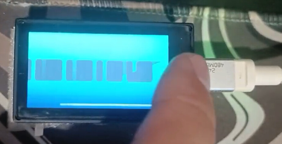

ESP32-S3 1.9inch Touch Display + Tearing
-The tearing issue when scrolling pages is no longer present, the correct configuration for ST7789V.
-LV_DISP_DEF_REFR_PERIOD 16ms
-full_refresh 1
-Double buffer
-Arduino IDE
  • MCU/MPU/Board: ESP32-S3
  • **LVGL version:8.3.6
