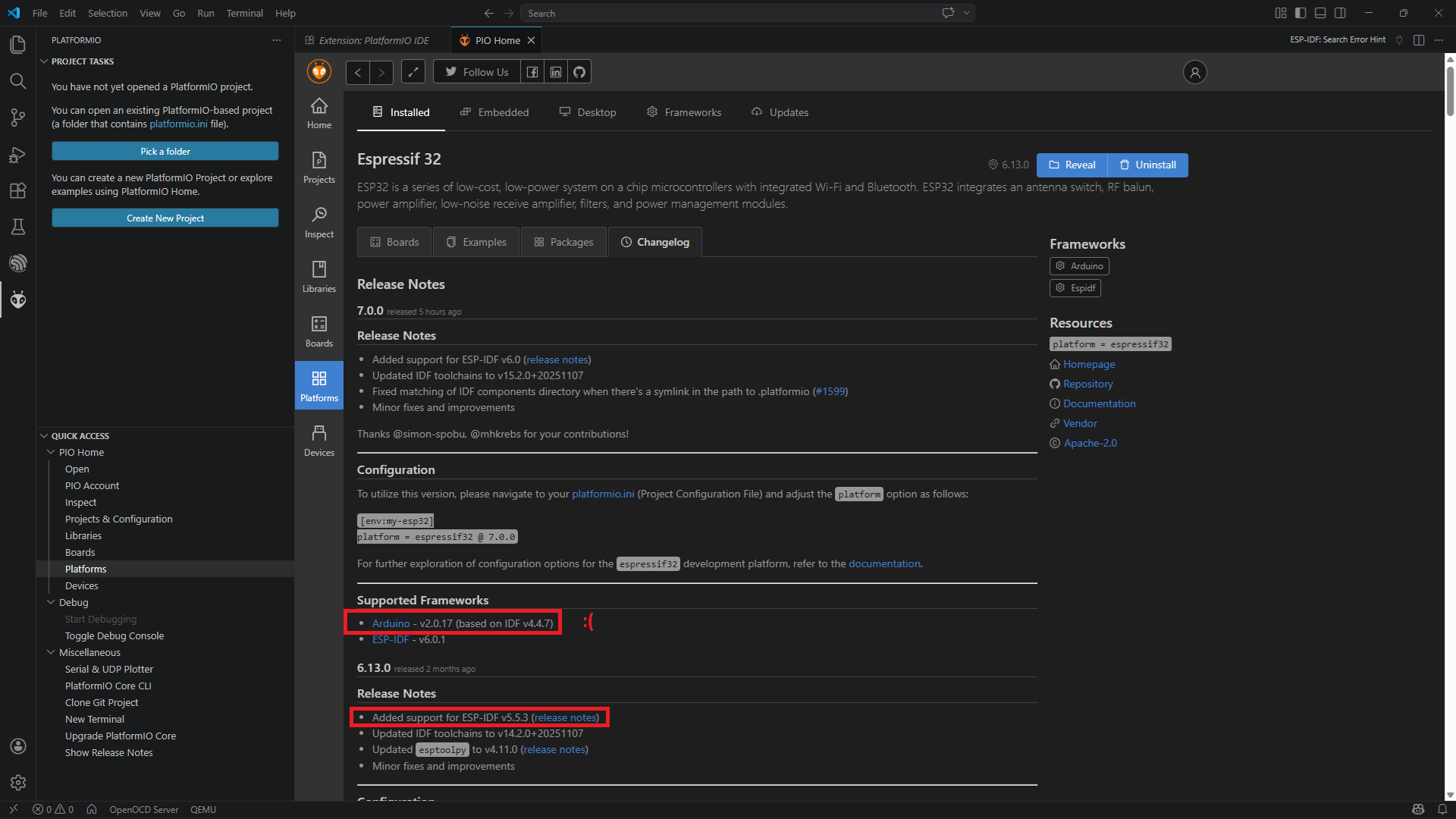

Actually for Arduino framework in PlatformIO are binding with IDF v4.4.7 where Vsync callback access was includet from V5.1 version
Self ESP-IDF for VScode is v6.0.1 available. I’d install before v5.3.3 and example: VIEWE 7" BOARD
compiling without errors and work flawlesly.

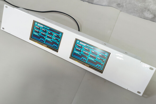

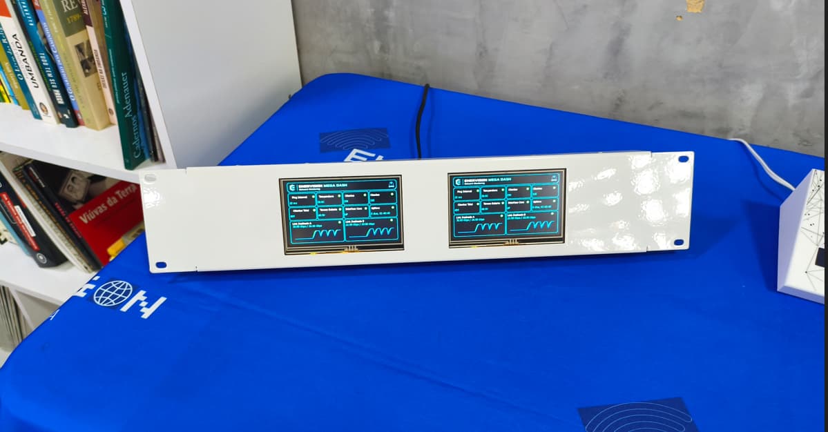

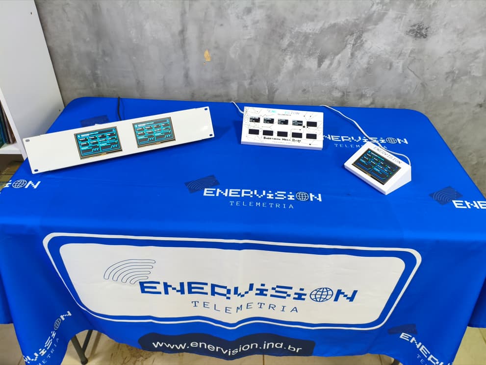

Many people ask questions about the code, but few take the time to show the final product!
I’d like to use this thread to do just that.
Link for more details: https://enervision.ind.br/produto/enervision-mega-dash-duplo/
@kdschlosser Thank you so much, without you none of this would be possible.
You’re welcome. While I am not apart of the LVGL development team I do want to make sure that you give them the majority of the acknowledgement. They are the ones that have put in a huge amount of time.
