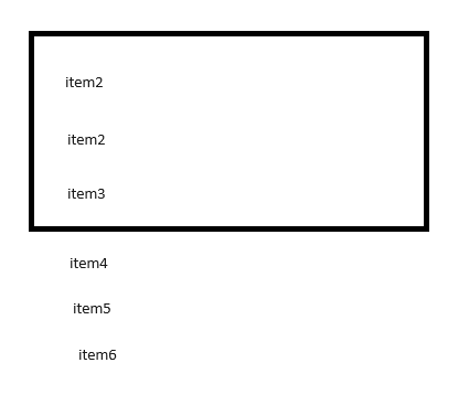

I don’t know if I explained myself well.
Referring to the image, it happens that when I scroll upwards, ‘item6’ arrives at the top (item1), instead I would like it to stop where item3 is now.
Can you show the code? Maybe you can solve this problem by setting the pad of obj.
lv_obj_set_style_pad_all(obj, 0, LV_PART_MAIN);
