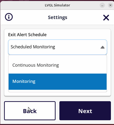

Screenshot from 2025-12-02 11-31-11
Screnshots:
  • The first image shows the desired dropdown appearance.
  • The second image shows the actual reasult, where the dropdown list height and text are not as expected.
Is there a solution to properly set the dropdown list height and prevent the text from being clipped when applying a different font style to the selected option?

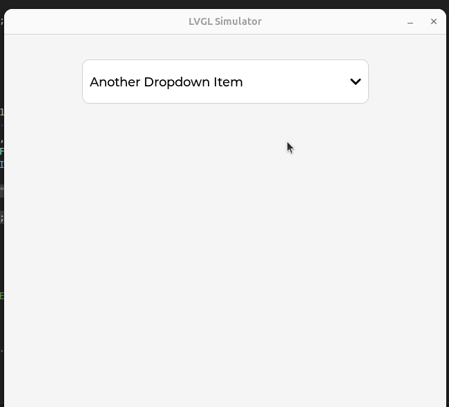

Hi, welcome to the community!
You could achieve the desired effect by adjusting a few properties from the dropdown list. Like this:
  lv_dropdown_set_options(dropdown, "Continuous Monitoring\n" "Scheduled Monitoring\n" "Another Dropdown Item");
  lv_obj_t * dlist = lv_dropdown_get_list(dropdown);
  lv_obj_set_style_text_font(dlist, &lv_font_montserrat_18, 0);
  lv_obj_set_style_text_line_space(dlist, 90, LV_PART_MAIN);
  lv_obj_set_style_max_height(dlist, LV_COORD_MAX, 0);
  lv_obj_set_style_pad_ver(dlist, 90/2, LV_PART_MAIN);
dropdown
I used big value 90 for line space so we can clearly see the height adjustment there.
Thank you.

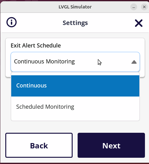

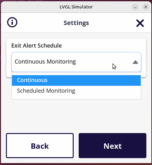

Yeah, I want to set different font style to the highlighted option.
Here are the images which shows text clipping of highlighted option.
The code I used is:
dropdown = lv_dropdown_create(lv_obj_1);
lv_obj_set_name(dropdown, “dropdown”);
lv_obj_set_width(dropdown, 415);
lv_obj_set_height(dropdown, 64);
lv_obj_set_y(dropdown, 36);
lv_obj_set_style_radius(dropdown, 10, 0);
lv_obj_set_style_border_width(dropdown, 1, 0);
lv_obj_set_style_border_color(dropdown, lv_color_hex(0xD1D1D1), 0);
lv_obj_set_style_text_font(dropdown, &opensans_regular_18, 0);
lv_obj_set_style_text_color(dropdown, lv_color_hex(0x000000), LV_PART_MAIN);
lv_obj_set_style_border_color(dropdown, lv_color_hex(0x74B4FF), LV_STATE_CHECKED);
lv_dropdown_set_symbol(dropdown, &icon_down_arrow);
lv_obj_set_style_transform_rotation(dropdown, 1800, LV_PART_INDICATOR | LV_STATE_CHECKED);
lv_dropdown_set_options(dropdown, “Continuous Monitoring\n” “Scheduled Monitoring”);
lv_obj_add_event_cb(dropdown, select_dropdown_option, LV_EVENT_VALUE_CHANGED, NULL);
lv_obj_set_style_bg_color(dlist, lv_color_hex(VST_COLOR_BTN_SELECTED_SKYBLUE), LV_PART_SELECTED | LV_STATE_CHECKED);
lv_obj_set_style_text_line_space(dlist, 50, LV_PART_MAIN);
lv_obj_set_style_pad_ver(dlist, 34, LV_PART_MAIN);
lv_obj_set_style_text_font(dlist, &opensans_regular_18, LV_PART_MAIN || LV_STATE_DEFAULT);
lv_obj_set_style_text_font(dlist, &opensans_semibold_18, LV_PART_SELECTED | |LV_STATE_CHECKED);
