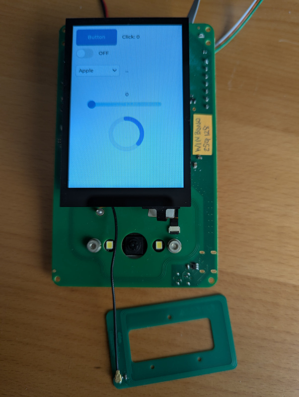

Two different configurations:
1/ custom board with STM32U5A5 + 320x480 LCD screen (ST7796S controller / RGB565 swapped) + I2C touch screen ; screen is connected to MCU with parallel bus, and I’m using MCU’s FMC hardware to write data to the LCD ; note that it’s a bare-metal application, there is no operating system.
Compiler is arm-none-eabi-gcc (GNU Toolchain for the Arm Architecture 11.2-2022.02 (arm-11.14)) 11.2.1 20220111
2/ simulator of above custom board, running on Linux Ubuntu ; simulator is quite accurate and simulates all required MCU & peripherals hardware. So I also have a simulator for the LCD display controller, touch screen, and all other chips on the custom board…
Compiler is gcc (Ubuntu 9.4.0-1ubuntu1~20.04.2) 9.4.0
Both configurations show same issue.
9.3.0
Once an item is selected, I would like the dropdown menu to close and the items list to be hidden.
I expect screen area behind the drop down list to be refreshed.

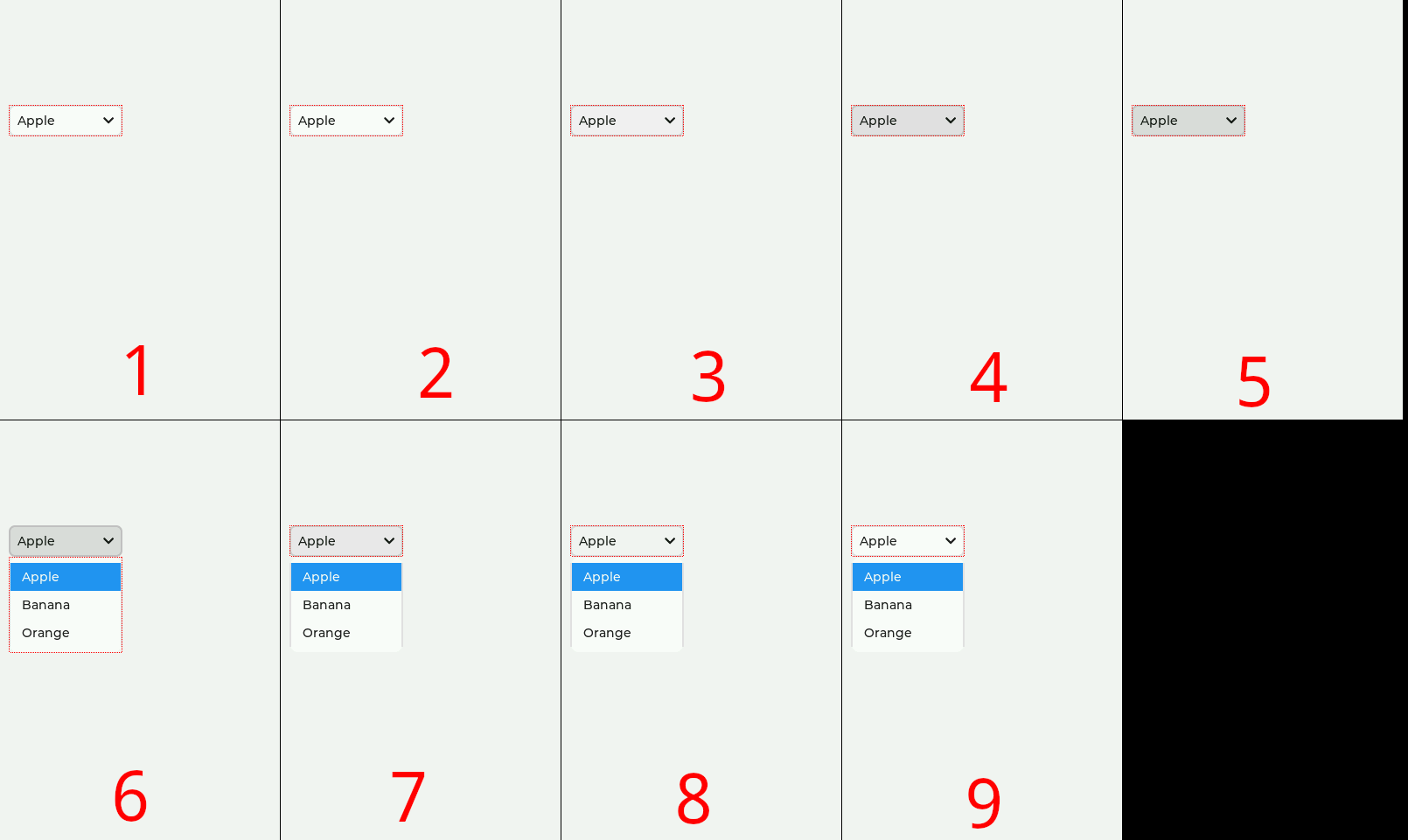

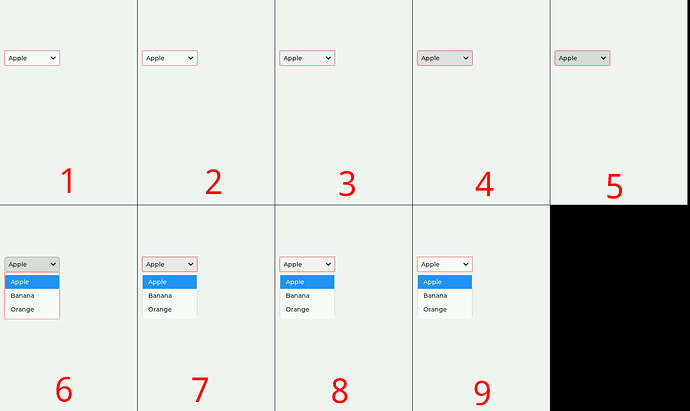

Above unit test makes LVGL perform 11 flush requests.
Touching screen on dropdown menu:
Steps 1 to 5 : finger is touching the screen
Steps 6 to 9 : finger has been removed from screen

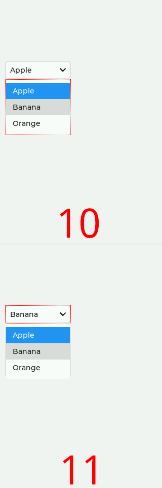

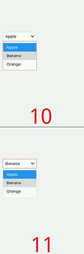

Touching 2 item in menu list
Step 10 : finger is touching item #2 on list (Banana)
Step 11 : finger has been removed from screen
Selected item (Banana) is visible on dropdown box.
But there is no refresh of the 3-items list.
I expect this area to be invalidated & updated on the LCD.

Extract of simulator log output.
Probably not very usefull.
You can see commands received by the LCD & touch screen simulators
CASET = Column Address Set (1st command to select pixel area)
RASET = Row Address Set (2nd command to select pixel area)
[2.05000] TEST: red=0xF0 green=0xF4 blue=0xF0
[2.05000] FT6336G: point #0 pressed at (80,140) ; reporting to X1H
[2.05030] LCD: ST7796S cmd `CASET'
[2.05036] LCD: ST7796S SELECT from=(10,0) size=(130,480)
[2.05036] LCD: ST7796S cmd `RASET'
[2.05044] LCD: ST7796S SELECT from=(10,120) size=(130,36)
[2.05046] LCD: ST7796S GRAM from=(10x120) size=(130x36) area 100% written
[2.05046] LCD: saving `output/LCD/host/version_test/bmp/001-internal_010-120_130x36.bmp' 320x480
[2.08304] LCD: ST7796S cmd `CASET'
[2.08310] LCD: ST7796S cmd `RASET'
[2.08320] LCD: ST7796S GRAM from=(10x120) size=(130x36) area 100% written
[2.08320] LCD: saving `output/LCD/host/version_test/bmp/002-internal_010-120_130x36.bmp' 320x480
[2.11604] LCD: ST7796S cmd `CASET'
[2.11610] LCD: ST7796S cmd `RASET'
[2.11620] LCD: ST7796S GRAM from=(10x120) size=(130x36) area 100% written
[2.11620] LCD: saving `output/LCD/host/version_test/bmp/003-internal_010-120_130x36.bmp' 320x480
[2.14904] LCD: ST7796S cmd `CASET'
[2.14910] LCD: ST7796S cmd `RASET'
[2.14920] LCD: ST7796S GRAM from=(10x120) size=(130x36) area 100% written
[2.14920] LCD: saving `output/LCD/host/version_test/bmp/004-internal_010-120_130x36.bmp' 320x480
[2.18204] LCD: ST7796S cmd `CASET'
[2.18210] LCD: ST7796S cmd `RASET'
[2.18220] LCD: ST7796S GRAM from=(10x120) size=(130x36) area 100% written
[2.18220] LCD: saving `output/LCD/host/version_test/bmp/005-internal_010-120_130x36.bmp' 320x480
[2.30000] FT6336G: point #0 released
[2.30018] LCD: ST7796S cmd `CASET'
[2.30024] LCD: ST7796S cmd `RASET'
[2.30032] LCD: ST7796S SELECT from=(10,156) size=(130,110)
[2.30034] LCD: ST7796S GRAM from=(10x156) size=(130x110) area 100% written
[2.30034] LCD: saving `output/LCD/host/version_test/bmp/006-internal_010-156_130x110.bmp' 320x480
[2.39905] LCD: ST7796S cmd `CASET'
[2.39911] LCD: ST7796S cmd `RASET'
[2.39919] LCD: ST7796S SELECT from=(10,120) size=(130,36)
[2.39921] LCD: ST7796S GRAM from=(10x120) size=(130x36) area 100% written
[2.39921] LCD: saving `output/LCD/host/version_test/bmp/007-internal_010-120_130x36.bmp' 320x480
[2.43205] LCD: ST7796S cmd `CASET'
[2.43211] LCD: ST7796S cmd `RASET'
[2.43221] LCD: ST7796S GRAM from=(10x120) size=(130x36) area 100% written
[2.43221] LCD: saving `output/LCD/host/version_test/bmp/008-internal_010-120_130x36.bmp' 320x480
[2.46505] LCD: ST7796S cmd `CASET'
[2.46511] LCD: ST7796S cmd `RASET'
[2.46521] LCD: ST7796S GRAM from=(10x120) size=(130x36) area 100% written
[2.46521] LCD: saving `output/LCD/host/version_test/bmp/009-internal_010-120_130x36.bmp' 320x480
[2.55000] FT6336G: point #0 pressed at (80,210) ; reporting to X1H
[2.55030] LCD: ST7796S cmd `CASET'
[2.55036] LCD: ST7796S cmd `RASET'
[2.55044] LCD: ST7796S SELECT from=(10,156) size=(130,110)
[2.55046] LCD: ST7796S GRAM from=(10x156) size=(130x110) area 100% written
[2.55046] LCD: saving `output/LCD/host/version_test/bmp/010-internal_010-156_130x110.bmp' 320x480
[2.80000] FT6336G: point #0 released
[2.80018] LCD: ST7796S cmd `CASET'
[2.80024] LCD: ST7796S cmd `RASET'
[2.80032] LCD: ST7796S SELECT from=(10,120) size=(130,36)
[2.80034] LCD: ST7796S GRAM from=(10x120) size=(130x36) area 100% written
[2.80034] LCD: saving `output/LCD/host/version_test/bmp/011-internal_010-120_130x36.bmp' 320x480
[3.05000] TEST: red=0xD8 green=0xDC blue=0xD8
Deep debugging
When running unit test with debugger, I can trace what is happening when touch screen controller reports “finger removed” when finger was on 2nd dropdown list item.
I have traced up to finding invalidating for area (10,156) → (139,265) which is the area of the list with the 3 items.
After that, I’m lost. I don’t have enough LVGL knowledge to figure out why this invalidated area is not flushed to LCD as it is supposed to be.
Call stack:
lv_indev_read
indev_pointer_proc
indev_proc_release
send_event(LV_EVENT_RELEASED
lv_indev_send_event
lv_obj_send_event
event_send_core
lv_obj_event_base
lv_dropdown_list_event LV_EVENT_RELEASED
lv_obj_event_base
lv_obj_event
lv_obj_remove_state
update_obj_state lv_dropdownlist_class 0x30 -> 0x10
cmp_res = LV_STYLE_STATE_CMP_DIFF_REDRAW
lv_obj_invalidate lv_dropdownlist_class lv_obj.c:923
lv_obj_invalidate_area lv_dropdownlist_class {x1 = 10, y1 = 156, x2 = 139, y2 = 265}
lv_inv_area
It’s very easy to reproduce this issue, so I’m able to perform any other required test / change / debugging.
Thanks for your help.
