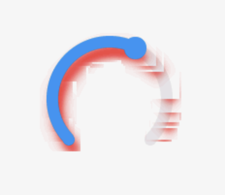

Trying to use drop_shadow, following the example for 9.5, and while it works, there are drawing artefacts left behind. Interestingly the example at Examples - LVGL 9.6 documentation exhibits exactly the same behaviour.
However, if I run the example in the lv_port_pc_vscode simulator it works just fine without the artefacts - this may be because it’s using full refresh for each frame (if I configure my display driver to use full refresh the artefacts disappear, but that’s obviously not an acceptable solution.)
Replicated the example (lvgl/examples/styles/lv_example_style_10.c)

Screenshot 2026-03-31 at 12.38.19 PM

It looks fairly clear to me that the problem is that the area being invalidated is not taking into account the shadow.
Hi @clydeps,
Thank you for reporting it. I’ve just sent a PR to fix it. Could you check it?
Yes, that’s a fix, thanks.
