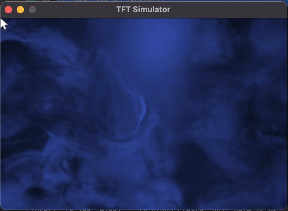

After completing in simulator the program i started to transfer it to esp32 and a ili9488 screen.
The folder used in simulator for the complete program is copied on the esp32 project.
In one . c file image declare function is used. Then a set background is called. In any case this function is the same but in display we get empty screen and in simulator it works properly.

## Screenshot and/or video
The simulator
(upload://oZXQpkv10lCFK10wWdscUJjsF0j.png)
The esp32:
(upload://caJJlyClPlrVO2tNI1AHZgcOAXo.jpeg)
