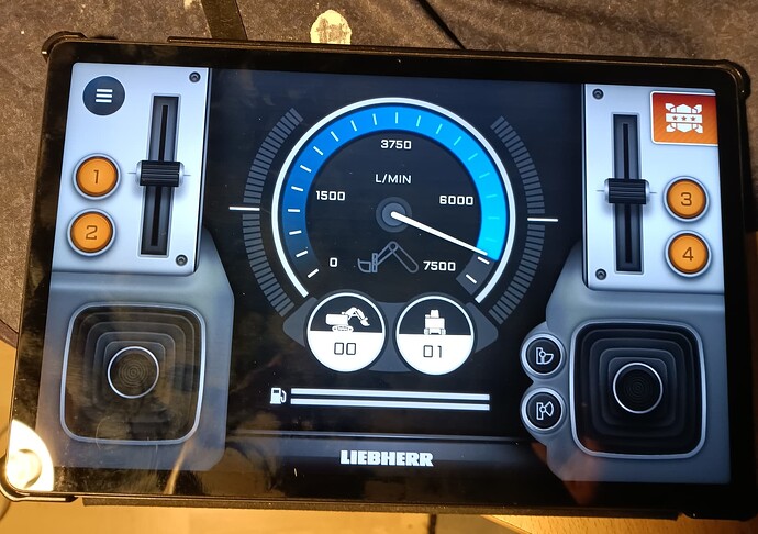

i would like to use my ESP32 to rebuild the user interfaces of some LEGO PU kits.
For example the Liebherr excavator.
The main controls of this are 2 , 2 axix joystikcs.
In some control cenarios you have to control botth joysticks.
  1. How can i build a 2 axis joystick ? Do you provide some type of touch area , wipe area where i can read the coordinates from , for example.

Hello @Ruppie
Can you share a screenshot of the interface?
That should be doable on LVGL with some C logic.
  1. The 2-axis joystick could be an object (knob) within a container, make it draggable and track the x and y position, it could also re-center on release if needed.
  2. LVGL multitouch support was already added. I have not tested it, but your touch controller would also need to support it
    How does lvgl support multi touch - #8 by kisvegabor
Here to find the screenshot of the Excavator GUI
