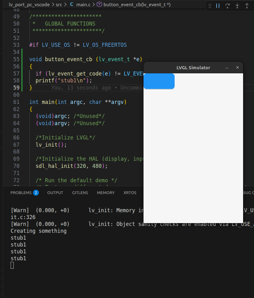

Hi José, I haven’t been able to identify the root cause of your problem. Could you provide more details about the project?
I tested it using the LVGL simulator, since I don’t have the same board, but I didn’t find any problems.

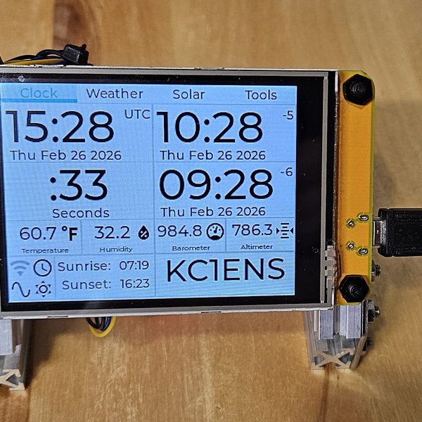

Second I am trying to get the following project to work with the CYD boards I bought from Amazon. I emailed the developer and he blamed my boards.
FYI: I got the app running with the assigment of the button handlers commented out. But without them you cannot set the time nor use the wifi so they are needed.
