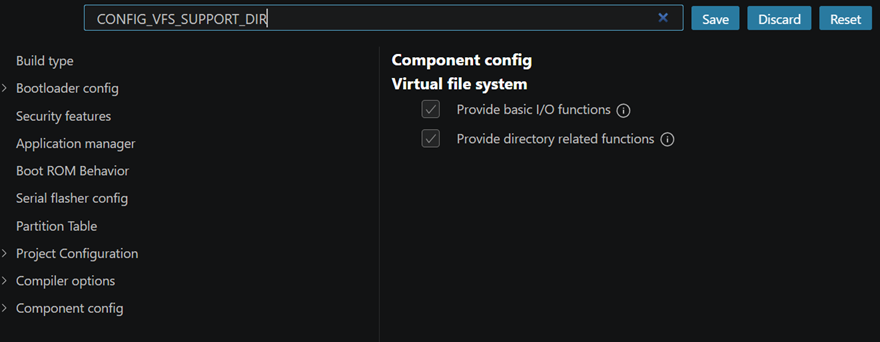

Hi @DickyOZ,
Could you check if you have enabled the following setting: CONFIG_VFS_SUPPORT_DIR?
Given that Espressif created an abstraction layer for FatFS, it’s important to understand what was implemented behind the scenes.
That config setting does not exist. But VFS_SUPPORT_DIR does.
I’ve messed around with this test project so much that it is now total mess. I will start again from square one, one step at a time.
