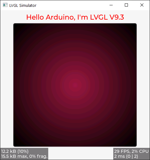

I wanted to get an image on the display in the form of a color wheel
I wrote this code
// Color wheel
void create_color_wheel(void)
    static lv_style_t style;
    lv_style_init(&style);
    // Defining colors for the gradient
    static lv_color_t grad_colors[2] = {
        //     LV_COLOR_MAKE(0x9B, 0x18, 0x42),  // Violet
        //     LV_COLOR_MAKE(0x00, 0x00, 0x00),  // Black
    // static lv_color_t grad_colors[3] = {
    LV_COLOR_MAKE(0xFF, 0x00, 0x00),  // Red
    LV_COLOR_MAKE(0xFF, 0x7F, 0x00),  // Orange
    LV_COLOR_MAKE(0xFF, 0xFF, 0x00),  // Yellow
    // static lv_color_t grad_colors[7] = {
    //     LV_COLOR_MAKE(0xFF, 0x00, 0x00),  // Red
    //     LV_COLOR_MAKE(0xFF, 0x7F, 0x00),  // Orange
    //     LV_COLOR_MAKE(0xFF, 0xFF, 0x00),  // Yellow
    //     LV_COLOR_MAKE(0x00, 0xFF, 0x00),  // Green
    //     LV_COLOR_MAKE(0x00, 0x00, 0xFF),  // Blue
    //     LV_COLOR_MAKE(0x4B, 0x00, 0x82),  // Dark Blue
    //     LV_COLOR_MAKE(0x8B, 0x00, 0x8B),  // Violet
    // Create params of gradient
    static lv_grad_dsc_t grad;
    lv_grad_init_stops(&grad, grad_colors, NULL, NULL, sizeof(grad_colors) / sizeof(lv_color_t));
    // Create radial gradient
    lv_grad_radial_init(&grad, LV_GRAD_CENTER, LV_GRAD_CENTER, LV_GRAD_RIGHT, LV_GRAD_BOTTOM, LV_GRAD_EXTEND_PAD);
    // Set fradient as fone
    lv_style_set_bg_grad(&style, &grad);
    // Create an object with a new style
    lv_obj_t * obj = lv_obj_create(lv_scr_act());  // Create an object on the active screen
    lv_obj_add_style(obj, &style, 0);  // Add style
    lv_obj_set_size(obj, 400, 400);  // Set size
    lv_obj_center(obj);  // Center the object on the screen
But apparently the function
lv_grad_radial_init
does not accept more than two colors.
The code is loaded into the device and it enters a cyclic reboot.
What am I doing wrong?
