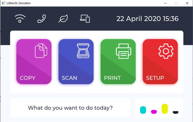

This is my first on this forum and i am very new LVGL.I am using the simulator currently and demo_printer. I am trying to change the page to another. I don’t want to show the animation. So how can i achieve the same.

As i mentioned i am using printer demo example and i want change the page without loading animation when i am clicking on icon “Copy”. attached is the screenshot.
