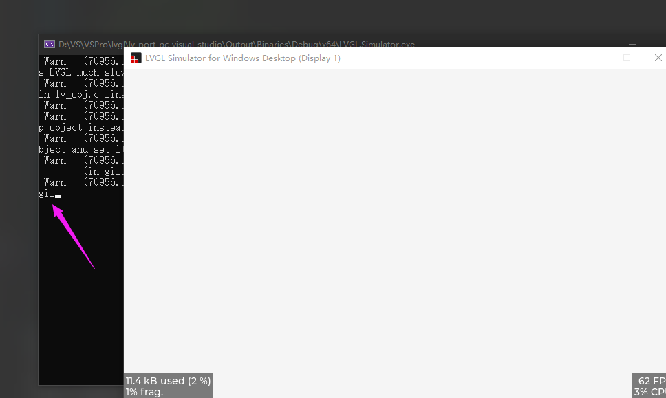

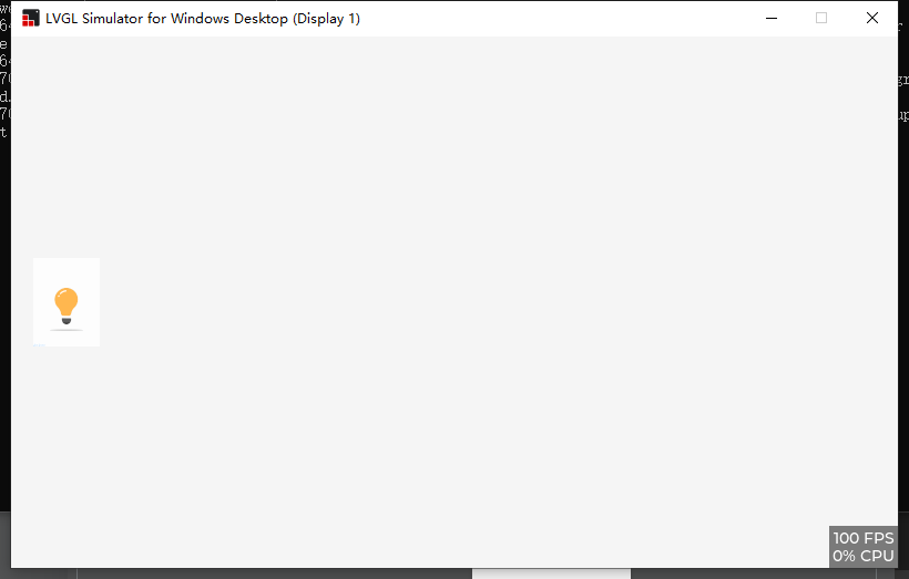

Show gif. I have success to use lvgl gif example already.
I use Online Image Converter and set Color format:CF_RAW to convert gif to raw data.
But it always convert to LV_IMG_CF_RAW_CHROMA_KEYED.It didn’t show gif.
Besides I saw LV_IMG_CF_RAW_CHROMA_KEYED need custom decoder function.Maybe it need
a decoder.
However I can just find PNG images decoder example,it is different.Can it use for git decoder function?

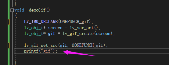

LVGL_Simulator.cpp:
void _demoGif()
    LV_IMG_DECLARE(ONEPUNCH_gif);
    lv_obj_t* screen = lv_scr_act();
    lv_obj_t* gif = lv_gif_create(screen);
    lv_gif_set_src(gif, &ONEPUNCH_gif);
    printf("gif");
