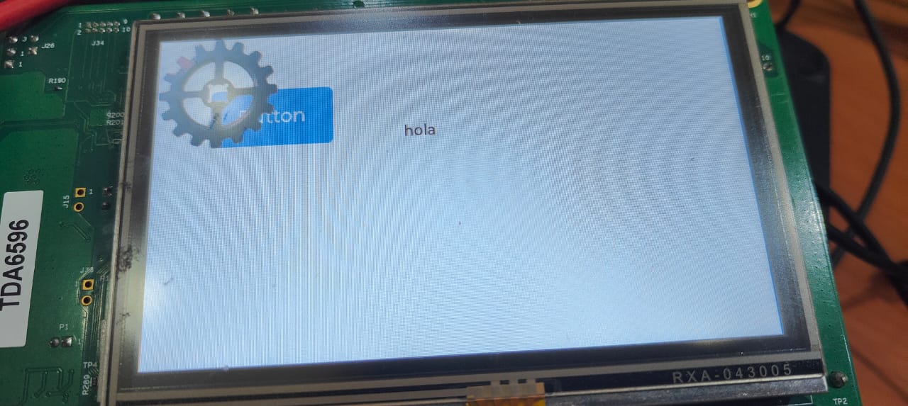

The image is declare and send in this function
void lv_example_img_1(void) {
lv_obj_t * img1 = lv_img_create(lv_scr_act());
lv_img_set_src(img1, &img_cogwheel_argb);
lv_img_set_pivot(img1, 50, 50);
lv_img_set_angle(img1, 0);
but my canvas doesnt work
