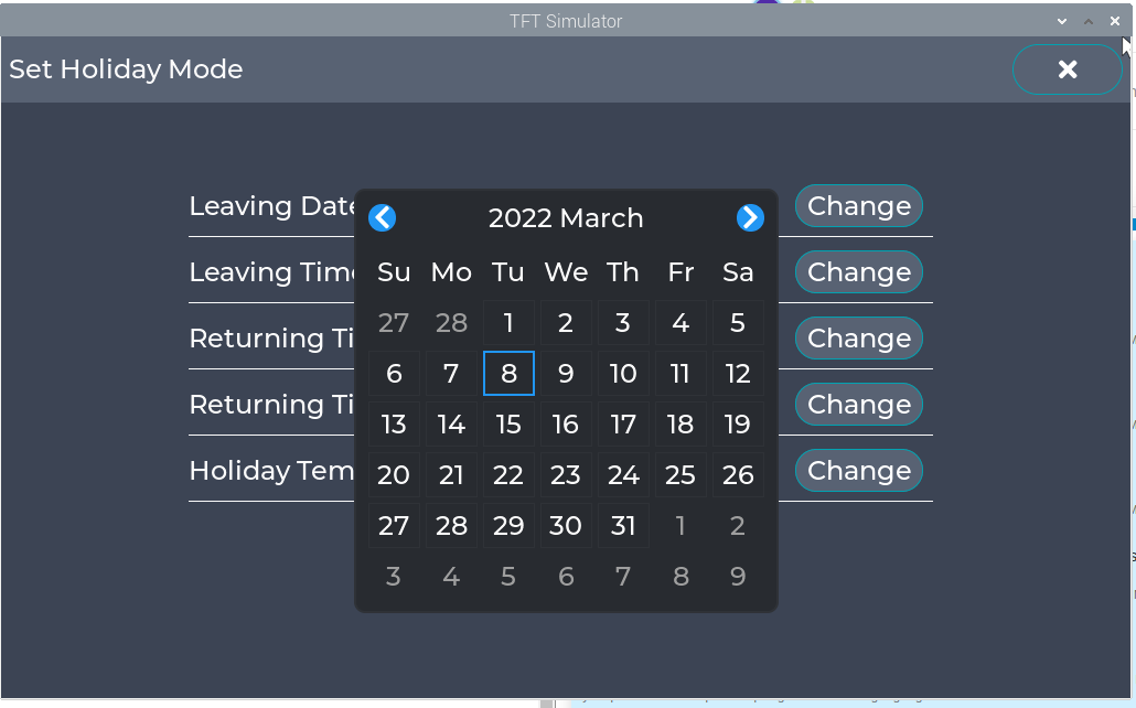

I have created a calendar on a window popup. Is there a cancel option to close it? If not what would be the bext way of closing/deleting the window?
Simuator
8.1
As described
Selecting the date and using the callback but I’d like an X button somewhere…
void cb_setLeavingDate(lv_event_t * event)
    lv_obj_t * cont = lv_win_get_content(holidy_mode_window);  /*Content can be added here*/
    lv_obj_t  * calendar = lv_calendar_create(cont);
    lv_obj_set_size(calendar, 385, 385);
    lv_obj_align(calendar, LV_ALIGN_CENTER, 0, 0);
    lv_obj_add_event_cb(calendar, cb_calendar_leavingDate, LV_EVENT_ALL, NULL);
    lv_calendar_set_today_date(calendar, 2022, 03, 8);
    lv_calendar_set_showed_date(calendar, 2022, 03);
    /*Highlight a few days*/
    static lv_calendar_date_t highlighted_days[1];       /*Only its pointer will be saved so should be static*/
    highlighted_days[0].year = 2021;
    highlighted_days[0].month = 03;
    highlighted_days[0].day = 8;
    lv_calendar_set_highlighted_dates(calendar, highlighted_days, 3);
    lv_calendar_header_arrow_create(calendar);
    lv_calendar_set_showed_date(calendar, 2022, 3);

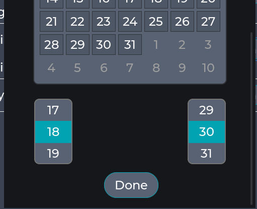

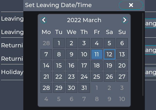

I’m not sure if its the best approach but I ended up wrapping the calendar in a window lv_win…
So, one way is that you can lv_obj_del(calender); when a callback is called or a confirm button is selected.
Yeh, I started down that route but I didnt want to close (delete it) when a date was selected and there wasnt anywhere to put a confirm button. Hence the window wrapper:
