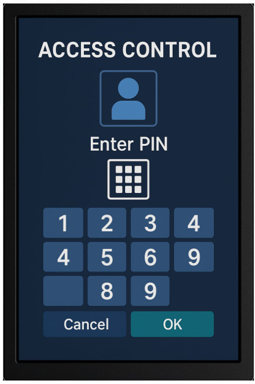

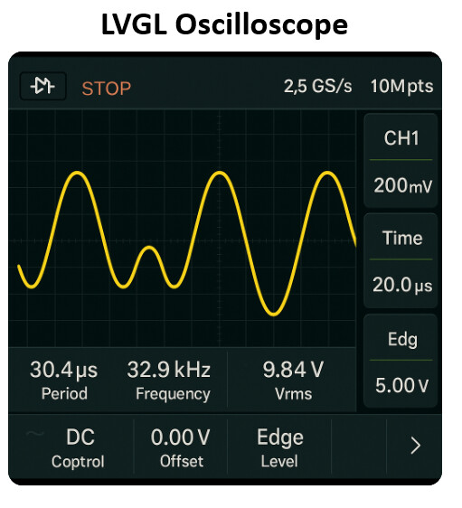

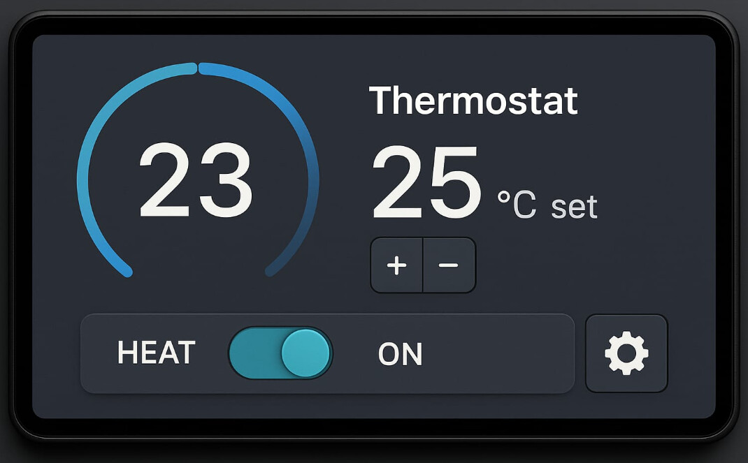

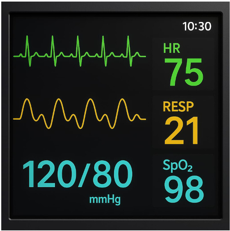

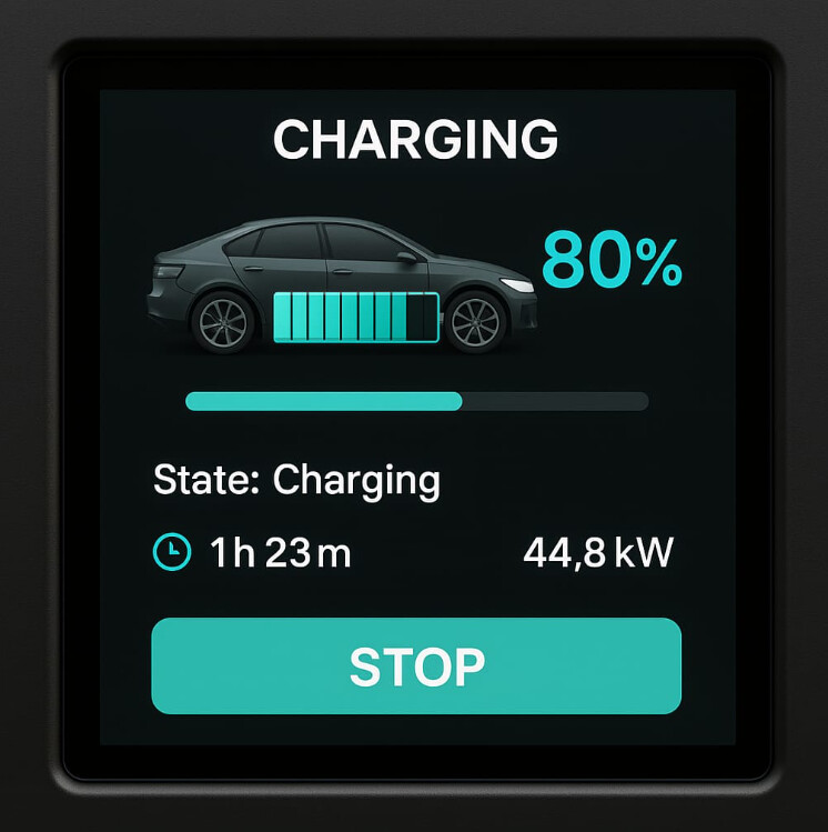

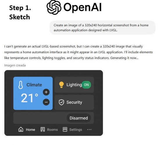

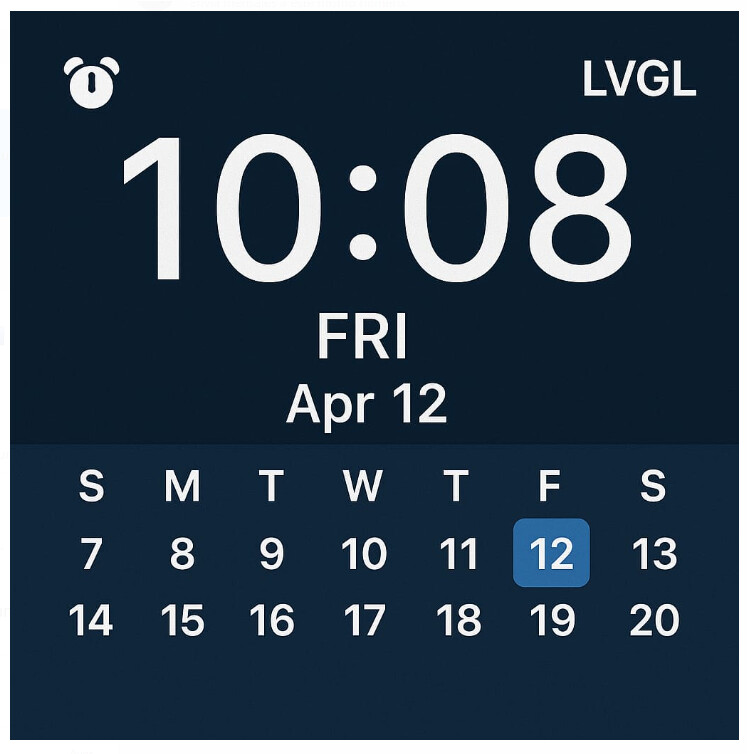

I came back here cause now you can sketch an UI with OpenAI news image generator and obtain something very professional:

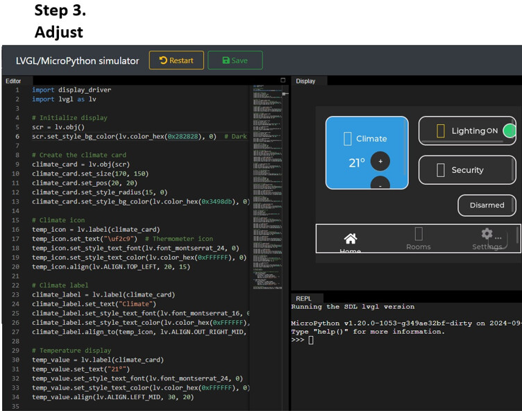

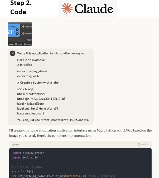

Then pass this image directly to Claude and got a well written 300 lines of UI initialization code (maybe you need to fix few API calls)

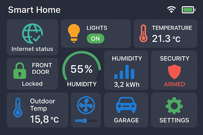

And, claude will put all the elements code, but make some mistakes, you can manually adjust the desing on the simulator

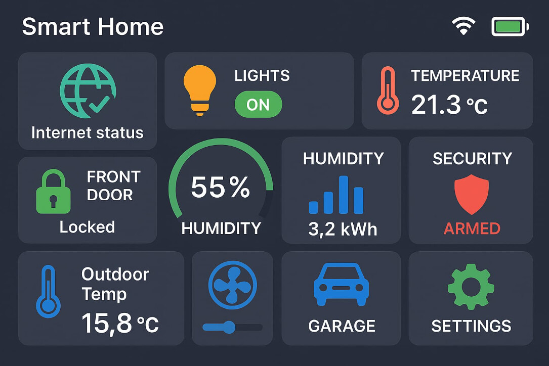

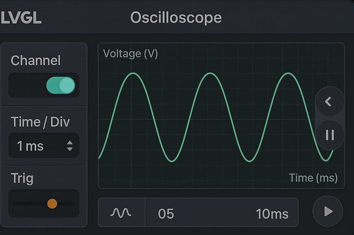

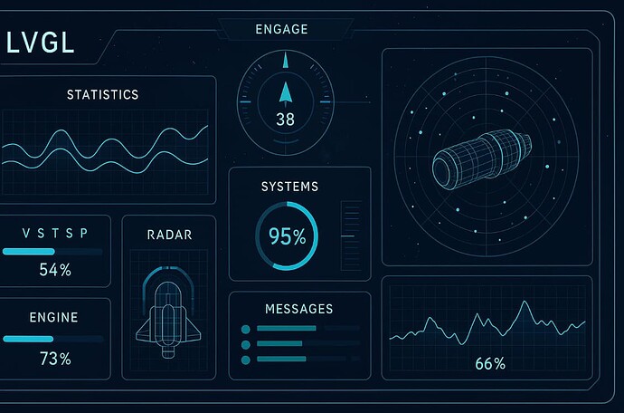

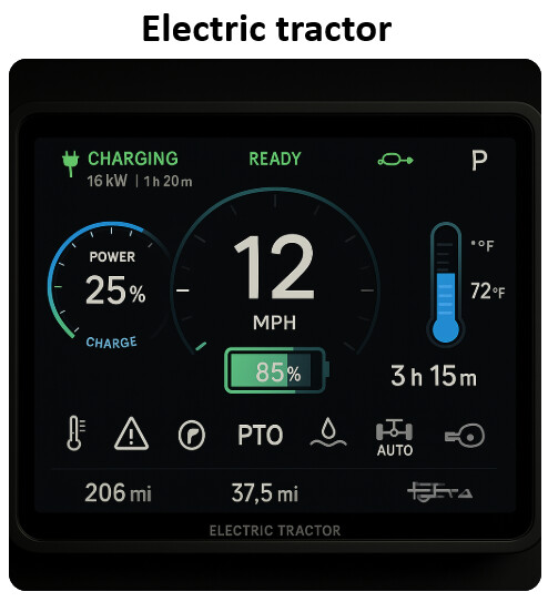

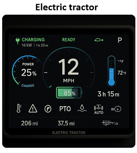

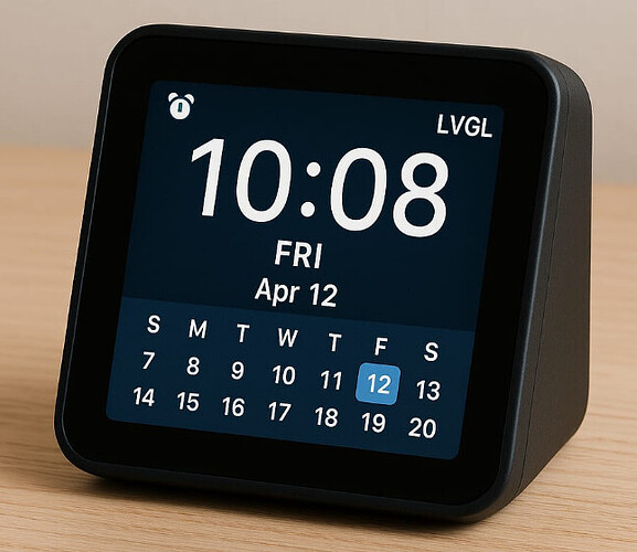

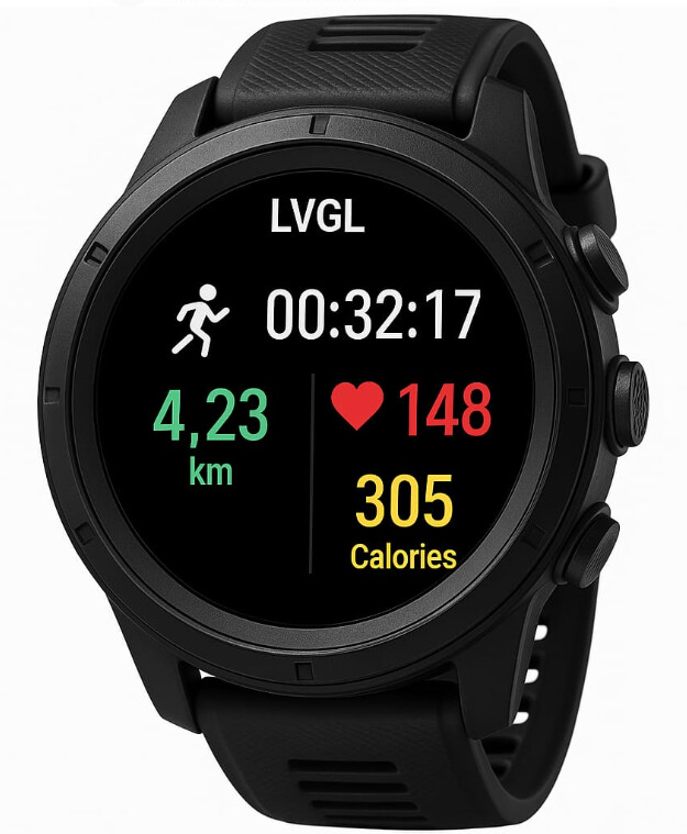

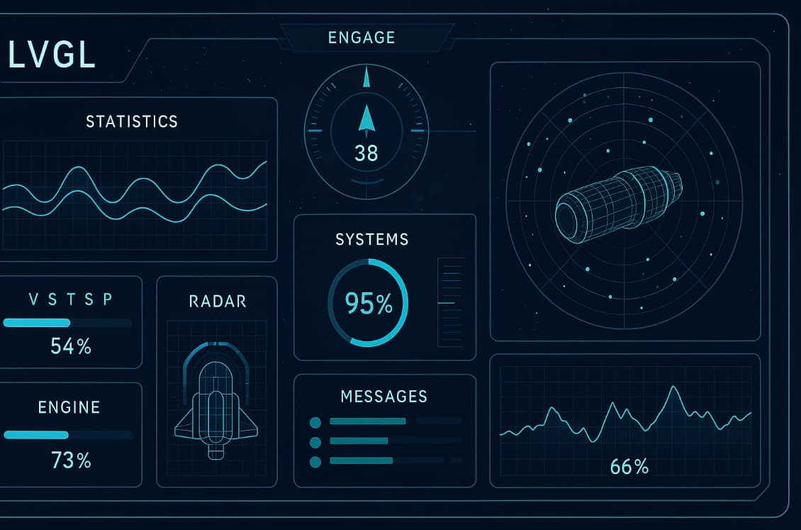

Some other mocks you can easily generate:

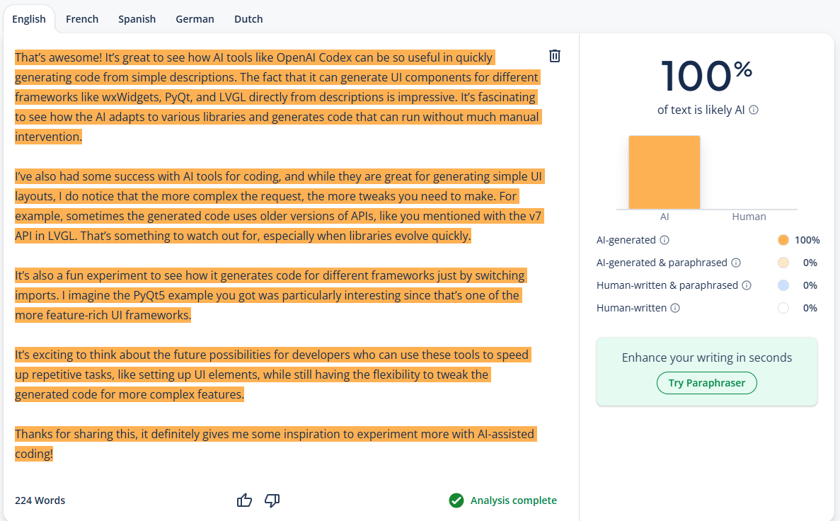

@Ovestint1964 have you generated your reply with AI because of a language barrier?
