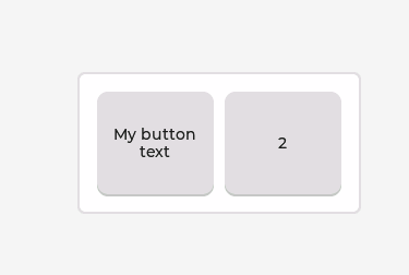

You can set the text alignment using LV_PART_ITEMS
static const char *btnm_map[] = {"My button\ntext", "2", ""};
lv_obj_t *btnm1 = lv_buttonmatrix_create(lv_screen_active());
lv_buttonmatrix_set_map(btnm1, btnm_map);
lv_obj_align(btnm1, LV_ALIGN_CENTER, 0, 0);
lv_obj_set_style_text_align(btnm1, LV_TEXT_ALIGN_CENTER, LV_PART_ITEMS);
Screenshot 2026-03-24 at 21.35.21
