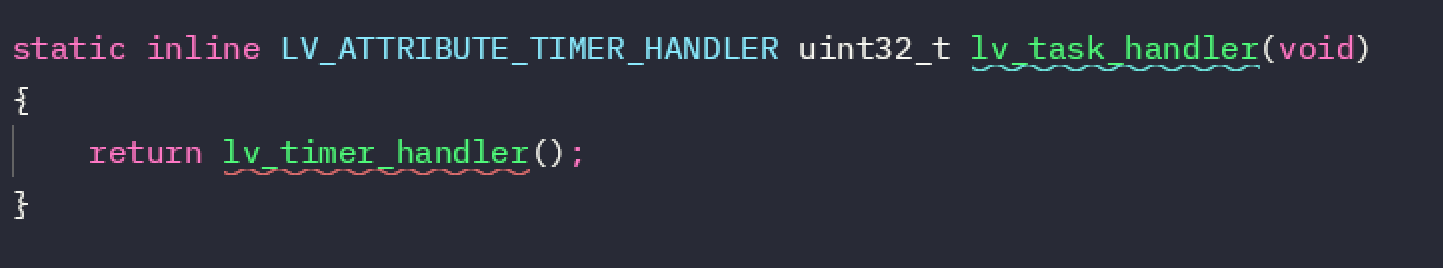

lv_task_handler() and lv_timer_handler() are basically the same.
See: lvgl/src/lv_api_map_v8.h at cee1a01743520095debd0eeff10739931f02c34b · lvgl/lvgl · GitHub
The idea is that lv_task_handler() returns a wait time and your code should wait that time before calling lv_task_handler() again. If it’s earlier, also no problem (but if you are running an RTOS of some kind, you should delay somewhere).
Hey @demonskull , as said @theprogram01 lv_task_handler() and lv_timer_handler() are exactly the same thing in v9.2, see the image below.
and could you share a repo that you are trying to run? it will be better and more easy to give you any advice.
