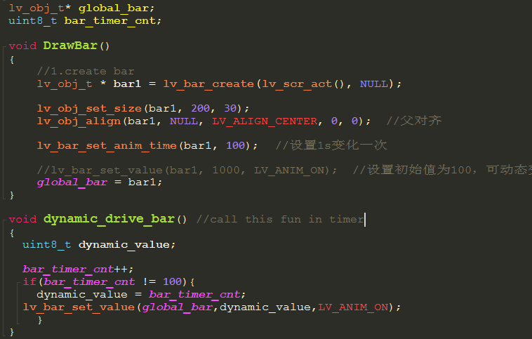

Hey, I just tried the bar object, it seems that “lv_bar_set_anim_time” function didn’t work even for 65s as you said, I guess this anim_time is not for bar driving but just a refresh time, the “value” in “lv_bar_set_value” fun maybe what you want, so i tried this: create a timer for counting time, and every second calls the"lv_bar_set_value" fun, and changing the value.
Like this,hope helpful.
I guess see you in whycan.cn
My mistake, in fun “dynamic_drive_bar”, it’s “<=” not “!=” in “if()”
