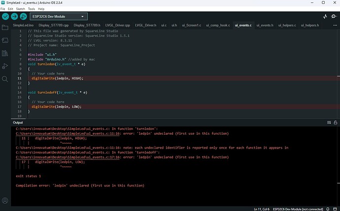

I have 2 buttons on my UI (Turn led on & Turn Led Off) in the generated ui_events.c file there is a pre-defined section for both button call function events with a section of commented out code saying “Your code here” when i place code here nothing happens and I get compile errors in the IDE
have tried lots of “includes” but all to no avail so thought best to ask the community rather than trying to guess and get lucky after 3 days.

Compilation Errors
C:\Users\innovatum\Desktop\SimpleLed\ui_events.c: In function 'turnledon':
C:\Users\innovatum\Desktop\SimpleLed\ui_events.c:11:16: error: 'ledpin' undeclared (first use in this function)
   11 |   digitalWrite(ledpin, HIGH);
C:\Users\innovatum\Desktop\SimpleLed\ui_events.c:11:16: note: each undeclared identifier is reported only once for each function it appears in
C:\Users\innovatum\Desktop\SimpleLed\ui_events.c: In function 'turnledoff':
C:\Users\innovatum\Desktop\SimpleLed\ui_events.c:17:16: error: 'ledpin' undeclared (first use in this function)
   17 |   digitalWrite(ledpin, LOW);
exit status 1
Compilation error: 'ledpin' undeclared (first use in this function)

The ledpin variable is not visible in ui_events.c
An option would be implementing the ui event functions directly in SimpleLed.ino
