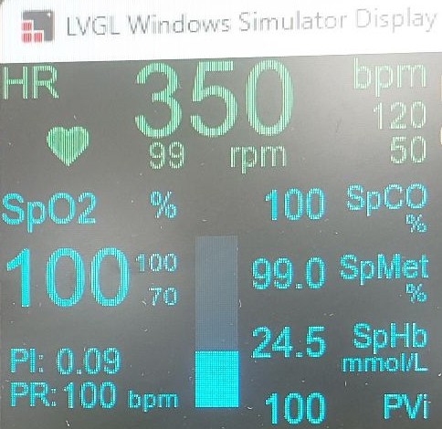

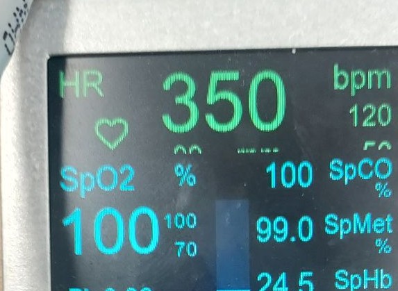

Hi,
These are the differences between Windows and my display.
As you can see on the display, the layouts overlap.
Display
Windows_Simulator
Best regards.
I see, and I have an idea: please change this line to
theme->disp_size = DISP_SMALL;
Does it make any difference?
Hi,
I needed to set DISP_LARGE for it to work properly.
Thanks for the help.
Great! Thank you for the feedback. These automatic size adjustments in the default theme are really causing headaches sometimes.
We will figure out something for that.
