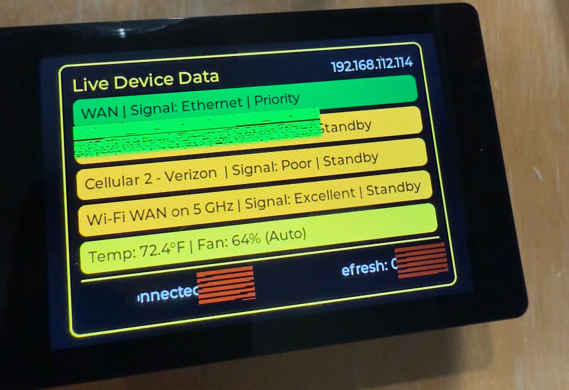

I’m working on a project where the ESP32-S3 receives an ESP-NOW message from a sensor node and updates the UI using LVGL. Everything works well until I trigger a command to send a “Fan OFF” ESP-NOW message back to the sensor.
After this send, my screen glitches, as if the draw buffers are corrupted or invalid. Areas of the LVGL UI becomes unreadable, and I have to reset the board to clear.

Right now my only option for fan control is to eliminate the “Fan OFF” all together. The fan PWM control is through a MOSFET, which does allow for the fan to maintain a complete OFF status without the use of a relay, but I’m running into this glitch. I’ve attached a photo for reference as well. I’m not really sure which parts of the code to share, as its quite extensive.
