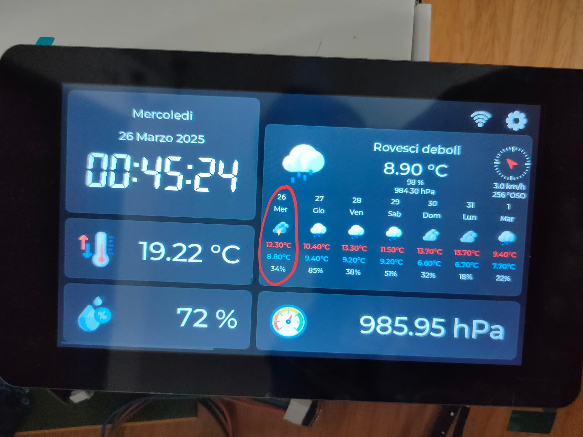

I’m trying to add a click event to the red highlighted area. It’s made up of five labels and an image (Every component takes up a single cell of the grid below).
Can someone help me with this?
If that’s not doable, are there any alternatives?
thanks for support
you need use lv_obj_add_flag(lable, LV_OBJ_FLAG_CLICKABLE);and lv_obj_add_flag(img, LV_OBJ_FLAG_CLICKABLE);
thanks,
That’s exactly what I needed
