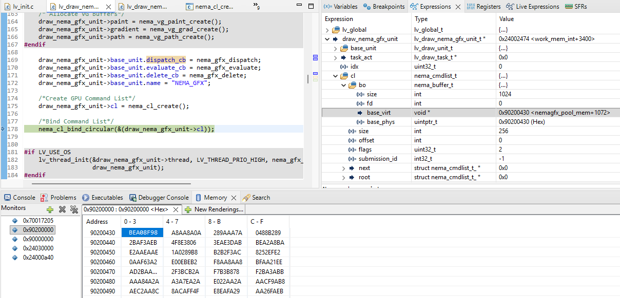

nema_init();
    draw_nema_gfx_unit->base_unit.dispatch_cb = nema_gfx_dispatch;
    draw_nema_gfx_unit->base_unit.evaluate_cb = nema_gfx_evaluate;
    draw_nema_gfx_unit->base_unit.delete_cb = nema_gfx_delete;
    draw_nema_gfx_unit->base_unit.name = "NEMA_GFX";
    /*Create GPU Command List*/
    draw_nema_gfx_unit->cl = nema_cl_create();
    /*Bind Command List*/

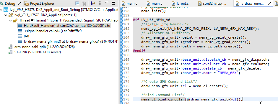

    nema_cl_bind_circular(&(draw_nema_gfx_unit->cl));
After nema_cl_bind_circular is called, the processor jumps to 0x00000000

Has anyone a working version of lvgl on a STM32H7S78 with nema-gfx running, or
does anyone have any idea why the processor jumps to address 0 after calling nema_bind?
The nemagfx_pool_mem buffer RAM is working and correctly initialized.
