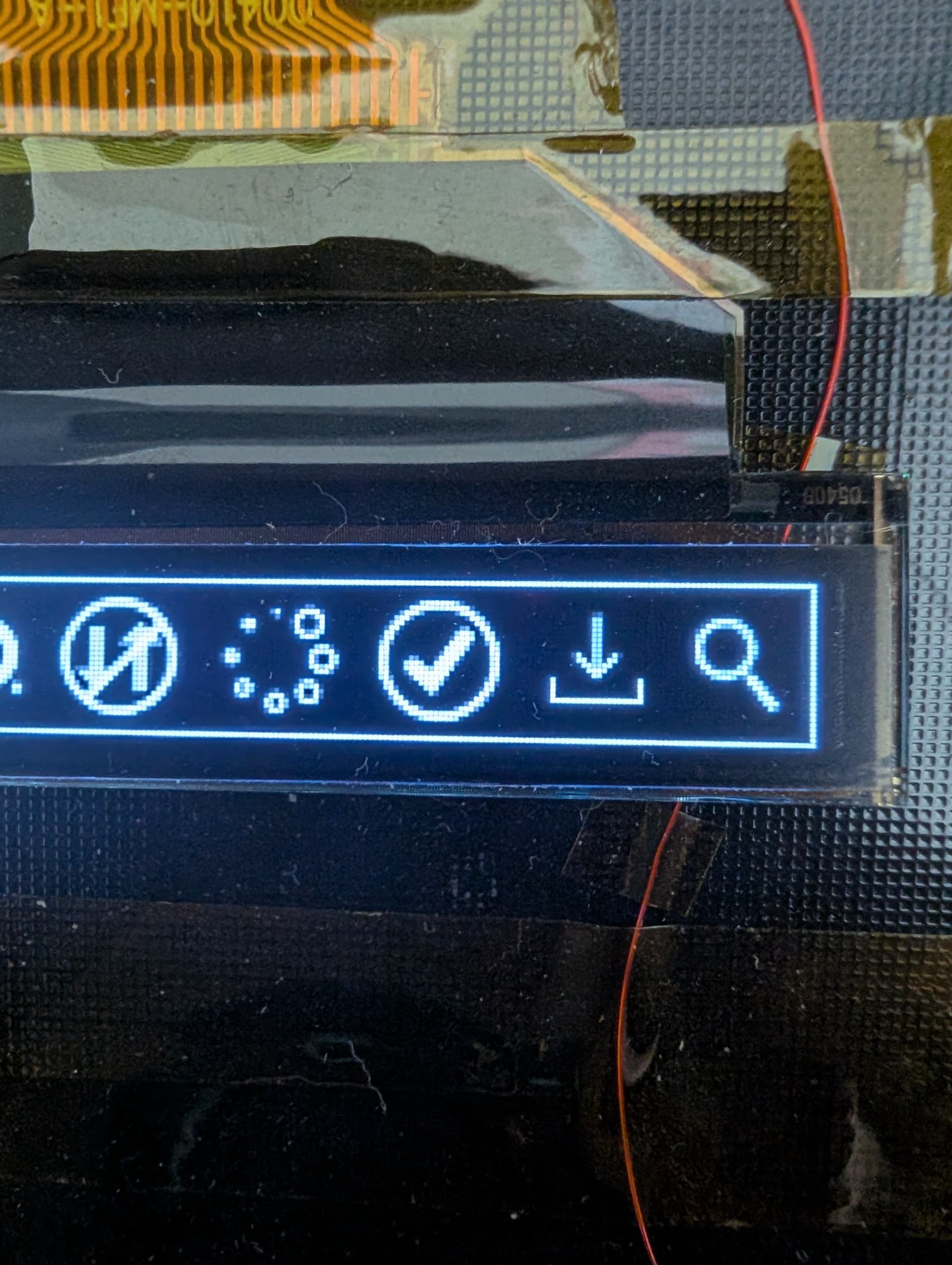

Integrate 4bit grayscale display with lvgl either via fbdev from 24 to 4 bit conversation or directly via custom driver
Tried converting 24 bit to 4bit for flush_cb custom code. But fonts and images are not clear on edges.
uint8_t color24ToGray4(uint8_t r,uint8_t g, uint8_t b)
    uint8_t gray = (uint8_t)(0.299 * r + 0.587 * g + 0.114 * b);
    uint8_t gray_4bit = (gray + 8) / 17; - this gives bolder font then normal
   uint8_t gray_4bit1 = (uint8_t)(pow((double)gray / 255.0, 2.0) * 15); - this gives thinner then normal
    return gray_4bit;
