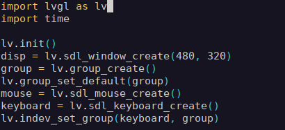

you need to change the example code at the top where it imports LVGL. Change it to a plain ol “import lvgl”… If you are doing this using PyCharm it gets a little bit more complicated because LVGL adds the root folder of the project into the search path for modules. There is an empty “lvgl” that can cause some issues.

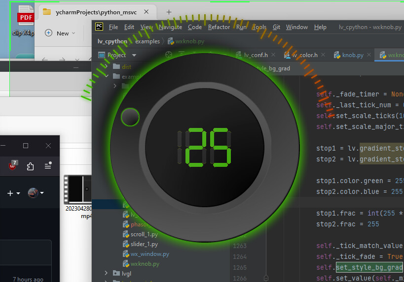

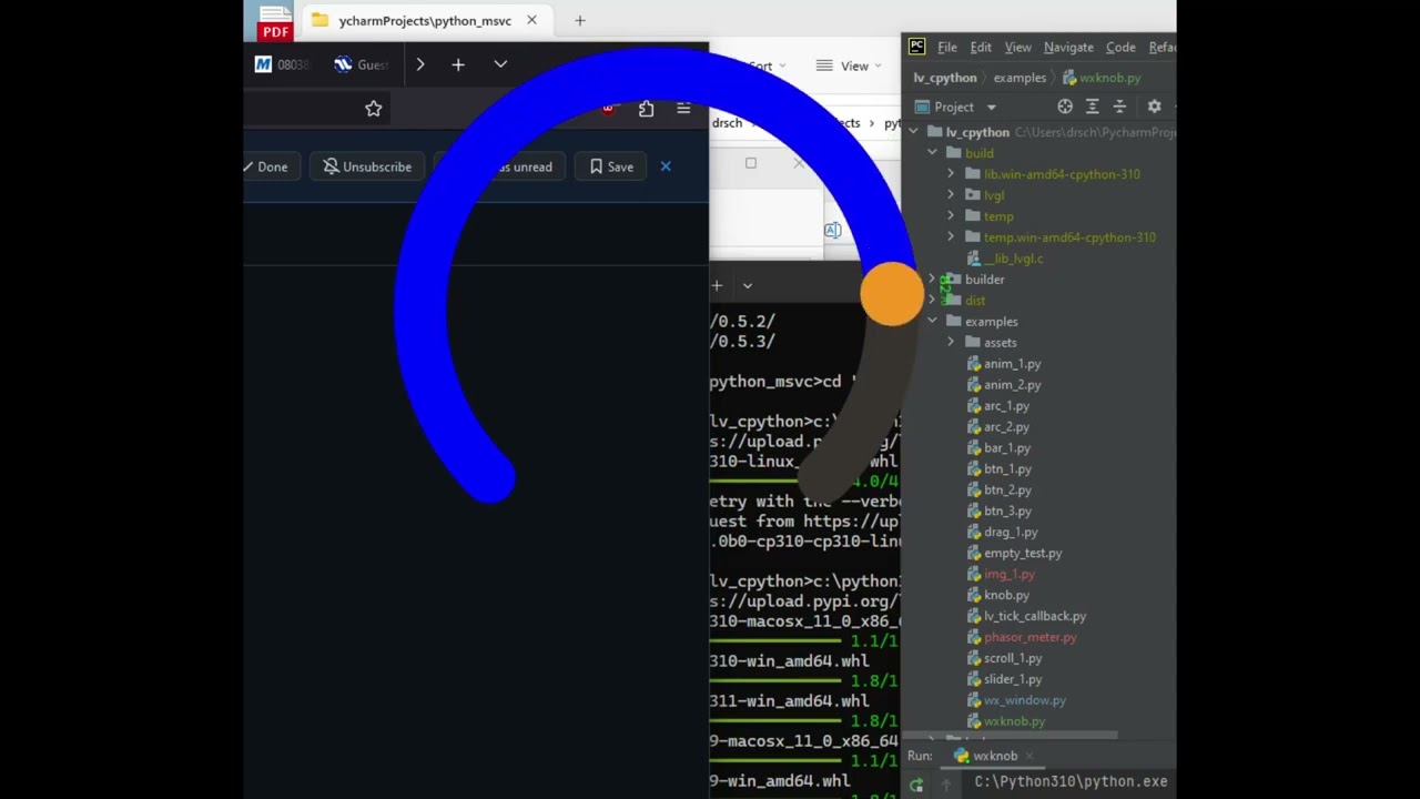

check it out…
LVGL using a transparent window
can you say On Screen Display?? OOoOooooO…LOL
knob with transparent window
Truly amazing!
With this
I got:
$python3 arc_1.py
Traceback (most recent call last):
File "/home/kisvegabor/projects/lvgl/python3/arc_1.py", line 1, in <module>
import lvgl as lv
File "/home/kisvegabor/.local/lib/python3.9/site-packages/lvgl/__init__.py", line 3, in <module>
from . import __lib_lvgl as _lib_lvgl # NOQA
ImportError: cannot import name '__lib_lvgl' from partially initialized module 'lvgl' (most likely due to a circular import) (/home/kisvegabor/.local/lib/python3.9/site-packages/lvgl/__init__.py)
Could you comment on this? ![]()
