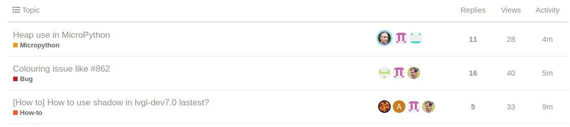

I’m working on a layout that has a lot of buttons with left- and right- aligned text on an esp32. I think this kind of layout is reasonably common – for example, on this forum each topic has the title text left-aligned and replies/views/activity right-aligned. I’d love to use button matrices to implement this, as using individual lists and labels uses a whopping 80kB of memory just for the layout. I know that I could use several button matrices on top of each other to draw multiple pieces of text on each button, but it looks like there is no way to align the text in each of the button matrix’s buttons to anything other than the buttons’ respective centers.

Just to be sure, do you mean this view?
If so, it really would be a reasonable update. We could use buttons_style.body.padding.left/right
to set the spacing on the left and right.
It seems the alignment options can go to lv_btnm_ctrl_t
Do you agree?
Absolutely, that’s exactly what I mean!
